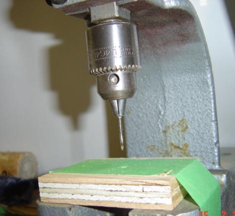

After reading this I went and dug out my arbor press, I had a three jaw drill chuck adapted to it several years ago which is perfect for holding a needle.
The only problem being the needle wants to stick coming out of the leather and bees wax doesn't help.
Mink oil helps and it will probably be ok on dyed leather but it might stain natural leather, not sure yet, still experimenting.
I don't have a sewing machine but I imagine that's what the foot does is holds the leather down.
The press makes it cowboy simple for punching holes in leather.
Kevin.
Kevin.
Kevin,
Are you punching holes with a needle or an awl? I am using an awl blade, and it sticks a little, but I just hold my finger on the leather and it comes right out.. Can't really figure out why it is sticking so bad for you.
Terry
Terry;
You nailed the problem with it sticking.
I have a sewing awl needle in there and it's straight, that's why there's drag drawing the needle out.
I have another stitching awl on the way with spare blades so I'll pop one in when they arrive.
I'm sure that will work.
Making a better deck for the press today, looking forward to trying it on a project.
Thanks Terry!
