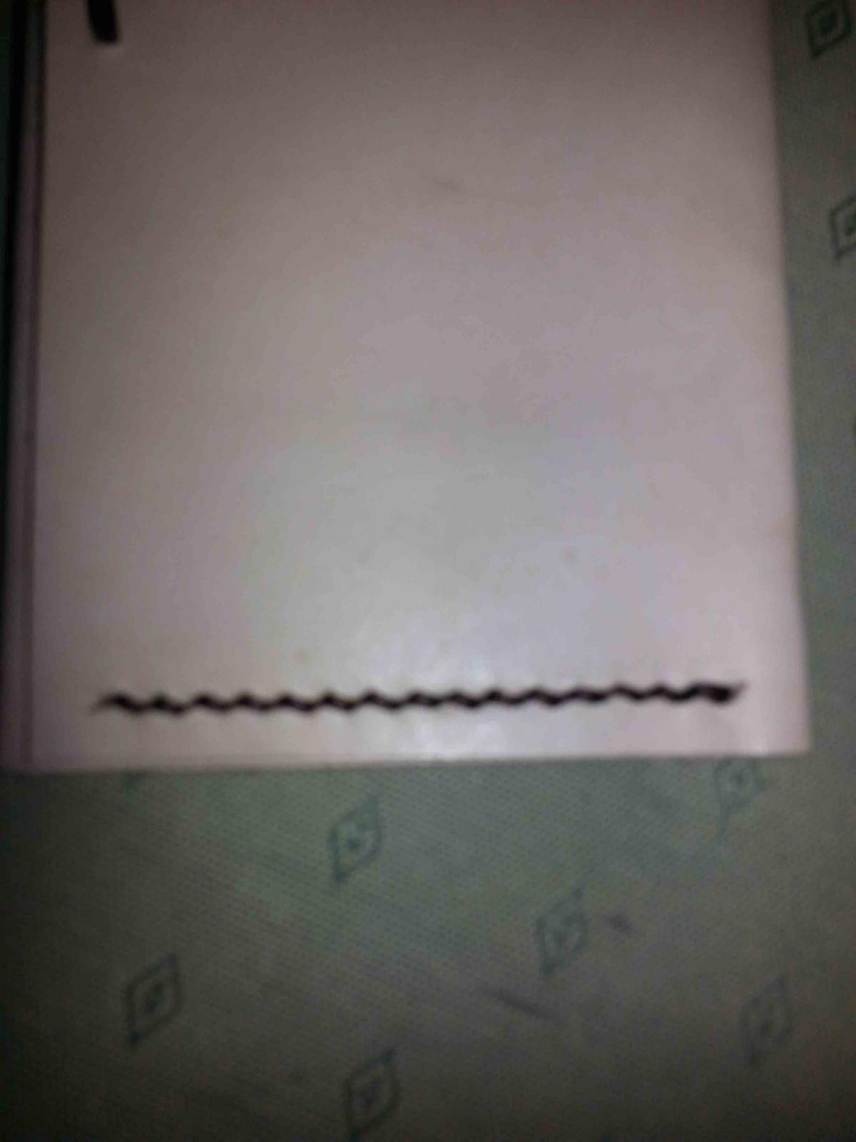

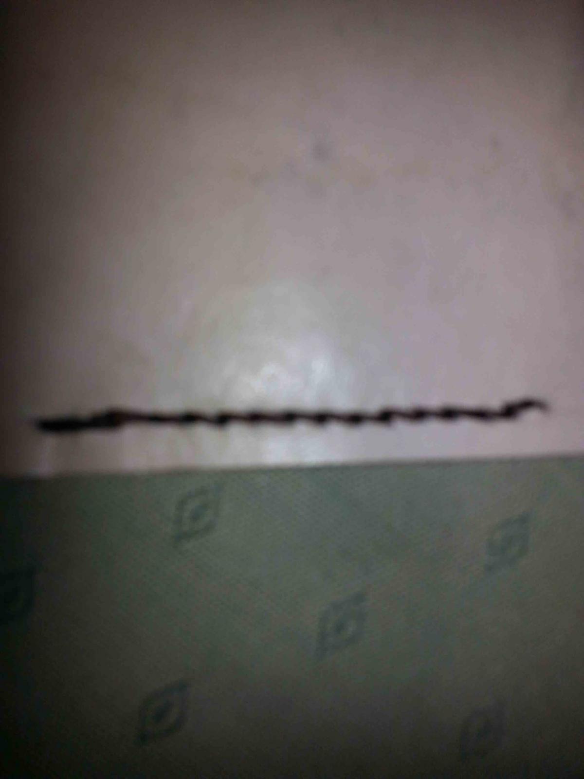

Backside Of Saddle Stitch Comes Out Different On Every Project.
The leather I'm using is 2.5oz calf leather, thread is .8mm tiger thread and stitching 7spi. Front side of the leather the stitching looks fine, however on the backside the stitches change from straight to slanted. Im not sure what is making the stitches change from project to project but one project can have slanted stitches on the back and the other the stitches on the back will be straight. Any tips will be great.

I played around with the back loop with every variation and they make the back better, at a loss of the slant on the front stitches. I believe throwing the stitch is what I'm missing.
Pictures attached will show how i stitch, please advise the technique of throwing the loop, I'm confused. I don't think I'm throwing the back loop over the thread at all because the two threads do not touch in the middle.
