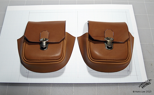

Front pockets.

post-32270-0-64817100-1381153536_thumb.j
post-32270-0-60309300-1381153545_thumb.j
post-32270-0-49615200-1381153553_thumb.j

Classy work hunio, nice design and quality leather.
love the pull tabs for opening the pockets, a nice design touch!

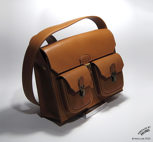

Last works.
I'm done my bag.
Thank you for watching! :-)

hunio..It was your work that got me hooked on to this forum! I saw all the stuff you made starting from thins bag to the green bean bag..the finish on everything you do is excellent and this is the exact kind of work I want to do! Cant I ask more about the stitching you have done on the bag? In terms of the style of stitch and the tools you used please? Also what kind of thread are you using? This is great stuff!!
Edited by greekgod
Really amazing work. Way out of my league.
Thank you greekgod.
that stitching is traditional saddle stitches everyone knows in this forum.
I used Blanchard griffe(http://www.vergez-blanchard.fr/) for stitching marks,
then I punched with small diamond awl.
Thread is waxed linen 532 thickness from france.
(http://www.sajou.fr/en/1239-cable-linen-corded-linen-leather-work-fil-au-chinois)
