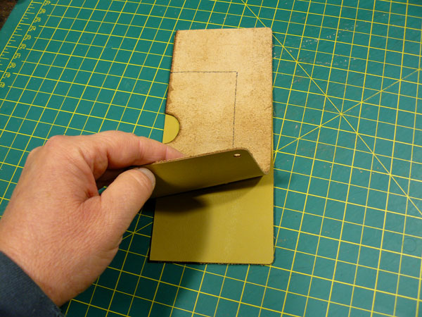

Okay, next thing we're going to do is take part #3 and mark stitching holes where the lines are for the small pocket on the flesh side.
Attached File  biker-wallet-18_600.jpg   89.09KB   2043 downloads
Then, turn it over and mark stitching holes around the bottom and side edges. This is for later.
Attached File  biker-wallet-19_600.jpg   73.5KB   2692 downloads

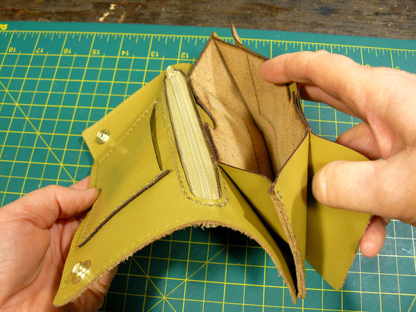

The last major step is to sew together the two halves of the zipper pouch. Just apply your adhesive to either half (or both, I guess, if you're using rubber cement), press them together with the edges lined up as best as possible, and stitch them together.
Attached File  biker-wallet-30_600.jpg   76.25KB   2941 downloads
Now all the parts are attached, and all the pockets are "functional", except for the second bill pocket, whose other half is the wallet cover.
Attached File  biker-wallet-31_600.jpg   94.5KB   2783 downloads Attached File  biker-wallet-32_600.jpg   107.5KB   2679 downloads
Finally, spiff up your edges by sanding them to get them evened up, dye, and slick them. No need to finish the edges on part 5 until you attach it to the cover. It probably goes without saying that the better job you do of cutting them out and lining them up, the less work you'll have to do at this point.
Attached File  biker-wallet-33_600.jpg   90.76KB   2676 downloads Attached File  biker-wallet-34_600.jpg   105.39KB   2798 downloads
And here's the completed interior of your biker wallet! I pointed out a couple of minor boo-boo's I made, so you might possibly avoid them.
