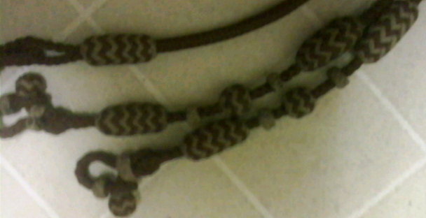

I actually made a romal rein out of parachute cord for a friend and she loves them. She said she has gotten quite a few compliments about them as well. I used a 4 strand round for the rein and i think a either an 8 strand around 2 for a core or a 12 strand for the romal and still put the buttons on the romal for the extra weight. For an everyday using set, they work pretty well. Sorry for the bad picture its actually the only one I have of them and its from my phone.
Sorry didnt mean to hijack your thread, just thought you might like to see some that someone else had made as well

Yeeees, youīre right! I like to see as many finished objects as possible! I really like the one you made it looks very professional. I suppose you took the core out of all the cords? Even those of the 4 strand core braid?

Thanks so much for the compliments. Those are about like everything else I make, I can see all the problems, but no one else notices them. That was the first project I made after getting Gail Hought's books and was finally able to do the long pineapple knots. Even though they are huge compared to ones you would make from leather, They add alot of needed weight to the reins as they are really light when you get everything braided up since I used 4 strand for the reins. I had A LOT of trouble getting the knots to be consistently the same size and shape and atleast one of them I remember didnt cover the tape job very well and you could see tape through the knot.
I actually didnt take the core out of any of the strands, except for the ones I used to make the buttons. The paracord that I was getting was premo stuff, but I still had what you described with the 8 strand braid where the back is a little wider than the front. I pulled each and every braid as tight as humanly possible and this didnt change. It ALWAYS did it, and I used 8 strand ALOT (for neck ropes and jerk lines). It does go away when you use a core as I have a 10 strand (8 with 2 strands as a core) mecate that I made a few years ago and its pretty round. But having said all that, I think that with use, your braids will kind of settle in (not loosen), and this goes away. You might also try rolling your finished product just like you do with leather/rawhide, I dont know but that might help.
