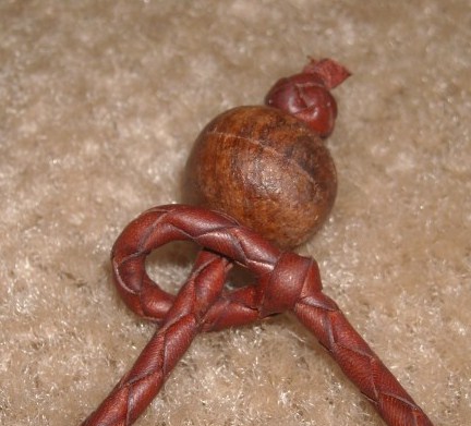

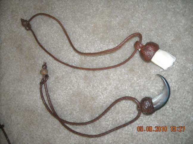

try something like this you can just use a smaller bead if you want or even punch the center out of a small button. these are necklaces i made for my kid a while back . i just took two laces and started the four strand braid around something approximately the same size and when i had enough i fed it through and made the loop then at the end i but the bead in but for the first one i made a nice terminal knot this one i don't remember how i made it i just played around with it. you can use anything or just build it up and put small pineapple over it but just make it small . hope it helps

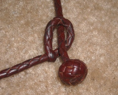

I made a lanyard for some ID cards I have and what I do is that when I get the length I want I start making a box braid with the last 2 layers going through the ring that I hang the cards on so that the box braid doesn't slide.
Here's a pic of what I did
