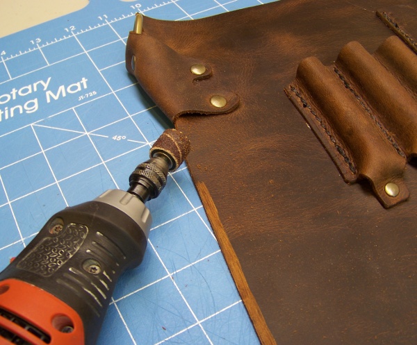

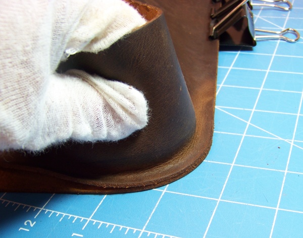

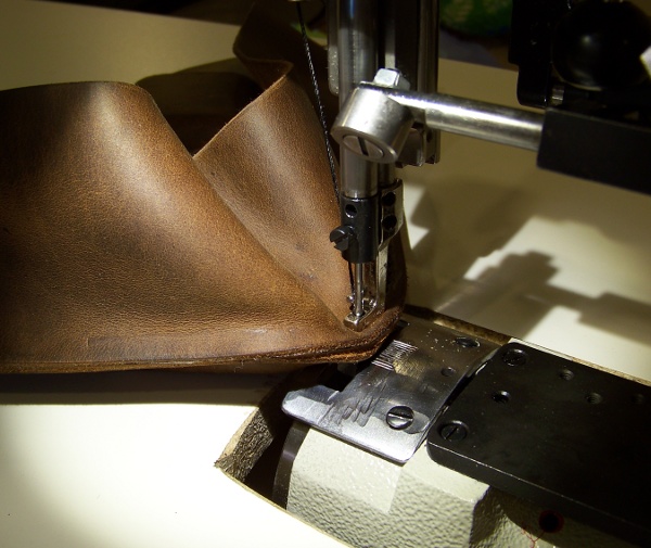

I like making bags out of thick leather and I had troubles with corners too.
The leather is rather stiff and hard to handle. Here is how I stitch gussets to the middle compartment separator of a handbag.
The bag is made out of 2mm oil tanned leather.
1. Prepare the edge of the pieces for the glue (this is oil tan and glue will not adhere if you do not rough up the surface)
2. Start gluing the gussets. As you approach the round corner fold the edge of the gusset and then while folded bend it to mimic the turn. I do it quite hard so the leather flexes, becomes more pliable and takes needed shape.
3. Glue pieces together and secure them with clips. (i should have wrapped them with something... they leave some impressions)
4. Stitch it all.
I hope it helps.
Equipment and materials used:
2mm oil tan leather, Cowboy 4500 sewing machine, round punch http://leatherworker...ndpost&p=216263, needle #25, bonded nylon #346, fabri-tack glue, rotary tool with sandpaper cylinder.
