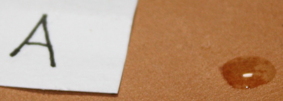

The following pictures show how well a water droplet beads immediately on leather with one application of the respective dressing. Dressing was wiped on with no buffing. Use the above letters for reference. The water droplet is in the upper-left corner of the picture:

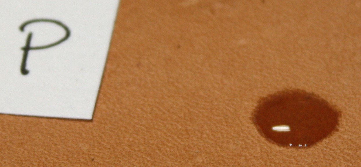

The following pictures show how well each respective dressing held up after 20 minutes, then after 30 minutes:

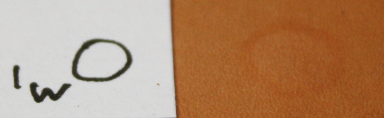

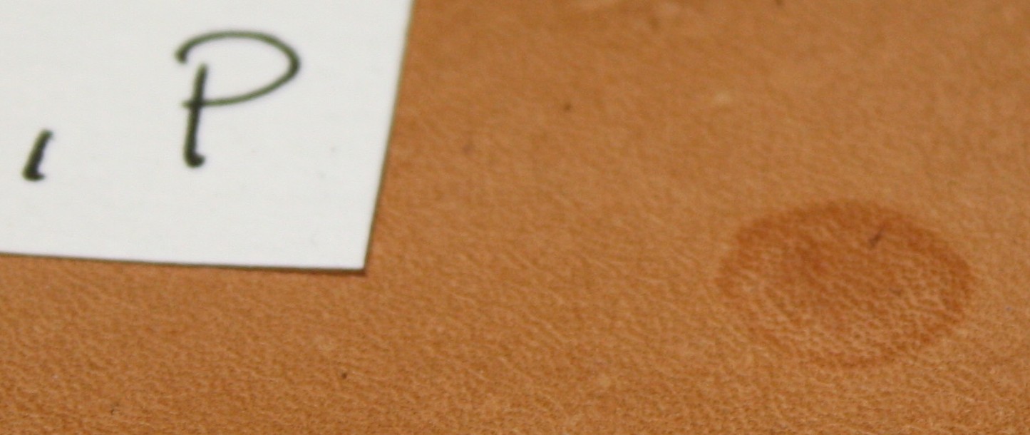

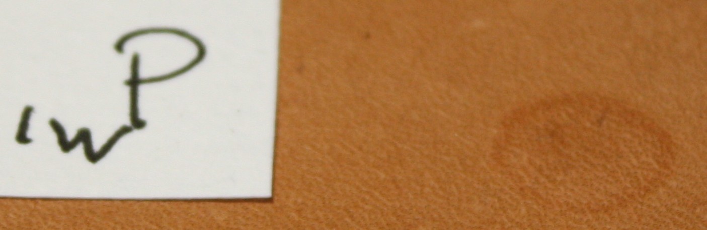

The following pictures were taken after 30 minutes and after the water bead had been wiped away to reveal the presence or lack of a water spot:

The first application of dressing was followed by a second application. This round of pictures is better annotated than the first. Again, dressing was wiped on with no buffing.The following pictures were taken immediately after second application was done:
The pictures that follow are annotated with "I" to indicate that they were taken after about twenty-five minutes:

The following pictures of the second application, annotated with "IIW" were taken after 45 minutes and after the water bead had been wiped away to reveal the presence or lack of a water spot:
