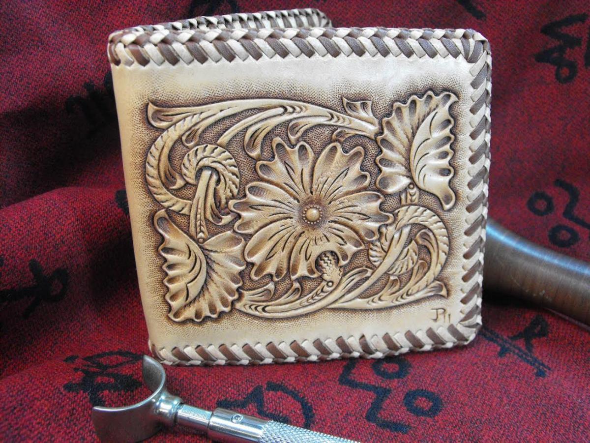

Can anyone offer some guidance as to how this beautiful contrasted look is achieved? I know getting the leather cased properly plays a large role in how dark the compressed areas are, but I've never been able to achieve such a contrasted look.
His cuts and stamping are almost black on some of the work this gentleman does.
post-42601-0-96633500-1406909440_thumb.j
That wallet has an antique applied to it after tooling. When I do it, I will first let the item dry after tooling. Then it gets a thin coating of Neatsfoot oil to condition the leather, then after that has set in overnight I apply a lacquer coating (Wyosheen, Clear-lac, etc.) and allow that to dry. Then I apply a antique gel or paste and wipe it back off. The lacquer keeps it from penetrating the leather and the antique remains in the tooled areas, creating the contrast.

If any antique has touched that I really need to know what he uses for a resist. The knife cuts and mule feet seem to have been but much of it looks like good burnishing. Even the backgrounding doesn't look to have been antiqued to me.
Thank you so much! I have all the tools I need, just didn't have the formula! I can't wait to try it.
I'm assuming this had a brown antiquing solution applied to it and not black. Tandy and I think Fiebings both have brown antique.
Yep, that's ant-streak. Fella kin tell by the mud puddles left behind ..
Looks like what I get with the Sheridan brown past that Fiebings sells. They have a large number of colors in their paste antiques.
