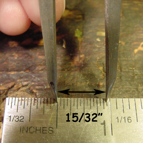

To layout where I'm going to use the tool, I set the gap on my dividers to 15/32". This gap will vary, of course, depending upon which tool you use.
Then, using a straight edge, I use the divider to scribe a pair of parallel lines that are guides to show where to place the bottom edge of the tool.

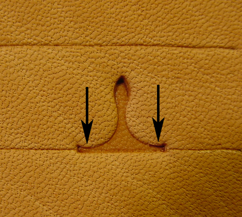

Place the bottom edge of the tool along one of the lines you scribed with the divider, like this:
The tool is designed so the adjoining impressions should overlap slightly. The arrows in this photo show the center point of the area where the impressions need to overlap to provide a (nearly) seamless transition from one impression to the next. It's pretty easy to spot because it's where back edge reaches its narrowest point.

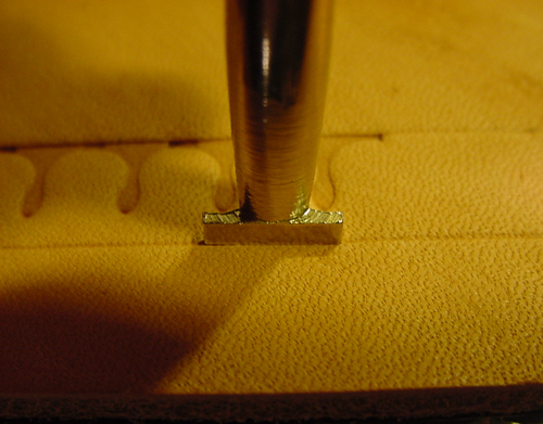

On the next impression, I get the best results by leaning the tool very slightly away from the previous impression, and placing the tool so the impressions overlap slightly.
Here are a couple of problems you might run into... In this photo, the overlap is about right, but I put a little too much pressure on the right side of the tool. This is why I lean it a little bit toward the direction I'm moving in, to avoid this:
In this photo, I made the impressions just a little to far apart, which created the appearance of that "ding" in the curve, plus it looks a little "fat". You want to overlap the impressions so the curves on the end match right up.

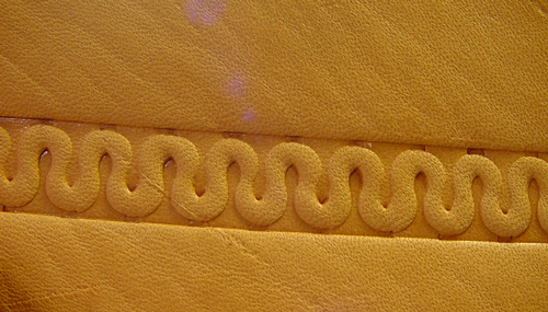

Here's what it looks like when I'm done. Generally, I try to end up with a "serpentine" curve, that is uniform in thickness throughout, and uniformity of the depth of the impressions.

In computer programming, we have what is called a "magic number", which my computer science professors frowned upon. It was a number that, rather than going to the trouble of writing our programs to calculate and solve for, we would just find the number (with a calculator or using some other low-tech method) and plug it into the program. You just caught me using one. Heheh!
I got the 15/32" figure simply from trial-and-error. Scribing lines 1/2" apart made the resulting curves on the sides look too "fat" compared to the middle. 7/16" made the sides look too "skinny" compared to the middle. 15/32" was the halfway point between them. For this tool, that gap was "just right". So for each of my meandering stamps, I waste a little scrap to find the best gap, and keep notes on what gap I use for each.

Well after getting guidance on the finer points of meandering from both Kate and Wayne Christensen - I have decided to share my not quite ready for prime time first attempt at using the tool, time to get humble in public!!. To add insult to injury i am working out a map case pattern (which in my case ususally look like hell till Ive done it about 3x and have worked the kinks out of my pattern and sewing efforts) - yeah so anyway I am making excuses, enough of that.
I was going to use a scrap, as my cross piece and said, what the hell, let me really make it scrap and well, this is what I came up with. Ok for a first attempt, but I learned a shite load using the tool and negotiating curves - this is a slow moving and carefully aimed tool, this meander, if your effort is going to satisfy you and your customer..gotta take your time and breathe - lots of looking over the tool
anyway, i also figured, really go for it and throw the lame beader blade effect (I love it but dont reach for it regularly - obvioulsy) in the mix and take the sloppy way and out and dimple the poorly cut corners with a seeder - ha!! If you look not too closely - you'll see i used a piece with a scar and worked that in- seems all of the work i have of mine is made from scraps....anyway - thanks Kate, I am going to apply myself a bit more till I can say I have a handle on this meander beasty
