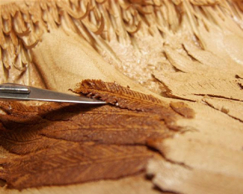

Clay Banyai With the tip of the scalpel, lift and separate the tips and edges of the feathers. Once the Drake’s X-1 dries, the feathers will stay in this shape. Do a small area at a time because it dries fairly quickly. It will darken the leather, but that’s ok. |
