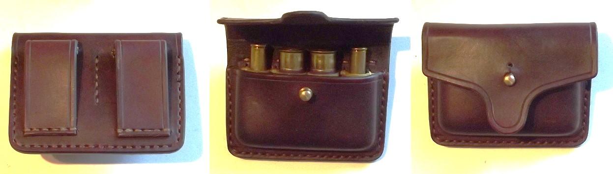

    A friend of mine in the States needed an ammo pouch for his 16ga / 7x57 combination gun so I made one for him. I also bought a new stamp to try out.... Roger
