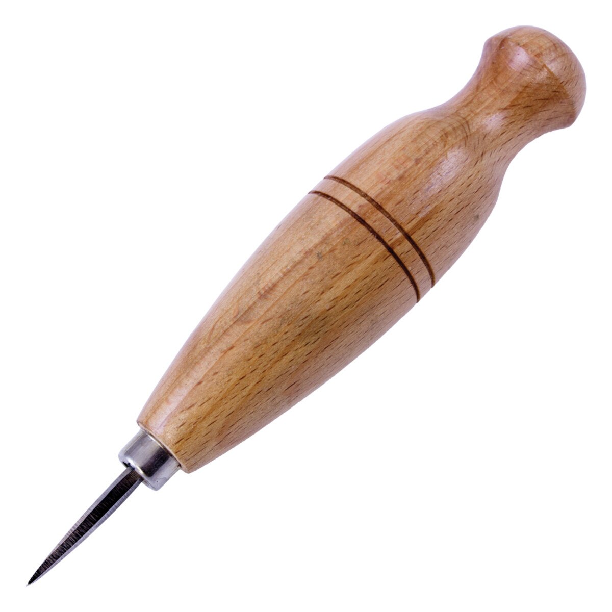

QUESTION- I'm a "newbie" and I bought a fid thinking it was what you use to make holes. I have an awl but it is a scratch awl with a round tip.  What I need is what the guy is using in the video- that makes a diamond shaped hole.  What is the tool called and the size hole in the video- what size point is best?  Thanks.
What you want is a diamond blade awl.  The size of the blade depends on the type of work you do.  There is no "one size fits AWL", sorry, couldn't resists.
This one is probably a good place to start.  After you get the hang of it and determine what size or sizes you need you can upgrade and invest in more quality hafts and blades.
https://www.springfieldleather.com/Stitching-Awl-Medium
