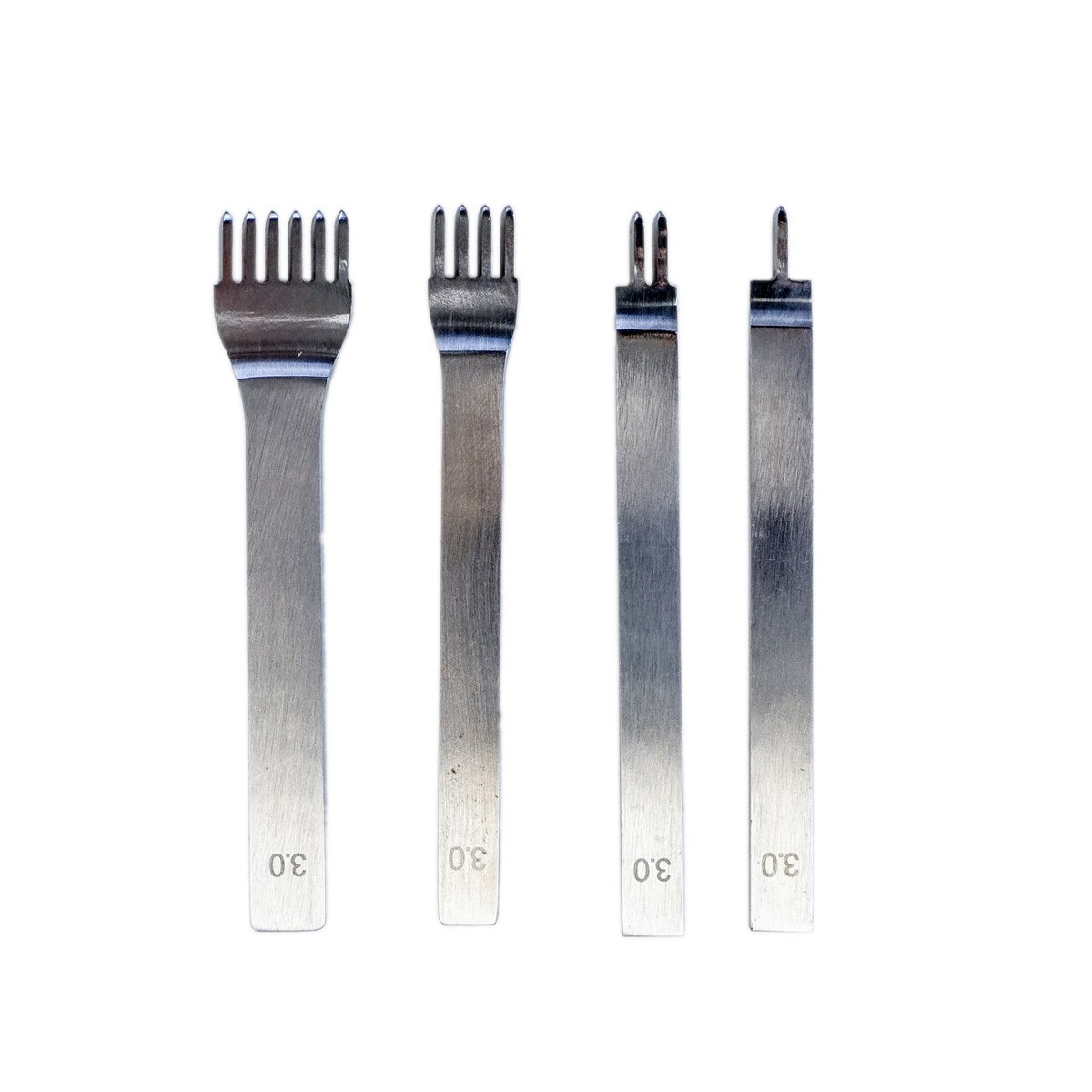

For the price, I have found these to be pretty effective.  For small wallets, the 3mm would be good.  EDIT:  No need to buy the one-prong iron in my opinion.  But if you buy the whole set, not a big deal, still less than $10 bucks per.
https://www.springfieldleather.com/Craftmaster-3mm-Diamond-Point-Stitching-Chisel?quantity=1&other-options=1
3DPSC.Set.01.jpg?resizeid=22&resizeh=1200&resizew=1200
i tried some similar to these, they bend really easily.
46 minutes ago, chuck123wapati said:
you need an awl before you need chisels or at the least at the same time.
Mine never have.  I own some of the black ones which Tandy sells and the tines on those are prone to bending.
One thing that helps is to make 100% sure that the chisel is plumb before striking it.  Another is to avoid twisting the iron when removing it from the leather.  I use a block of wood and pull straight up, and they release very easily that way.  The other negative to twisting is that it enlarges the holes.  The holes should only be large enough that you can easily pass the threads through.  Too large isn't good.  Tapping them down with a smooth-faced hammer helps, but it won't close up huge holes.
The most recent irons I purchased were the Aiskaer ones off of Amazon.  For the price, the quality is ridiculously good.  $9.99 and free shipping if you have Prime Plus.
https://www.amazon.com/Aiskaer-Diamond-Lacing-Stitching-Leather/dp/B014549SNG/ref=sr_1_5?crid=3GDG154QZX5W5&keywords=stitching+chisels&qid=1686580411&sprefix=stitching+chisels%2Caps%2C86&sr=8-5
mine were cheapo amazon, I replaced them with Tandy craft tool pro series and haven't had one bend yet and use them just the same.
The cheapos work ok and they do the job plus they are just as easy to straighten as they are to bend lol.
The Tandy Craftool Pro series irons are nice.  I own two sets, the 2.5 and the 3.5mm.  They are the diamond chisels and the only thing I wish was that they were a little more slanted and that the teeth were a tad narrower.  There are some irons on the market that I suspect would be perfect for my taste, but I'm not in the mood to spend $200.00 when the ones I have work nearly as well.
The ones from Tandy that bent were the black ones.  You can bend the teeth back one time, then they want to crack and fall off.  It is a shame, because otherwise they give a good result.
