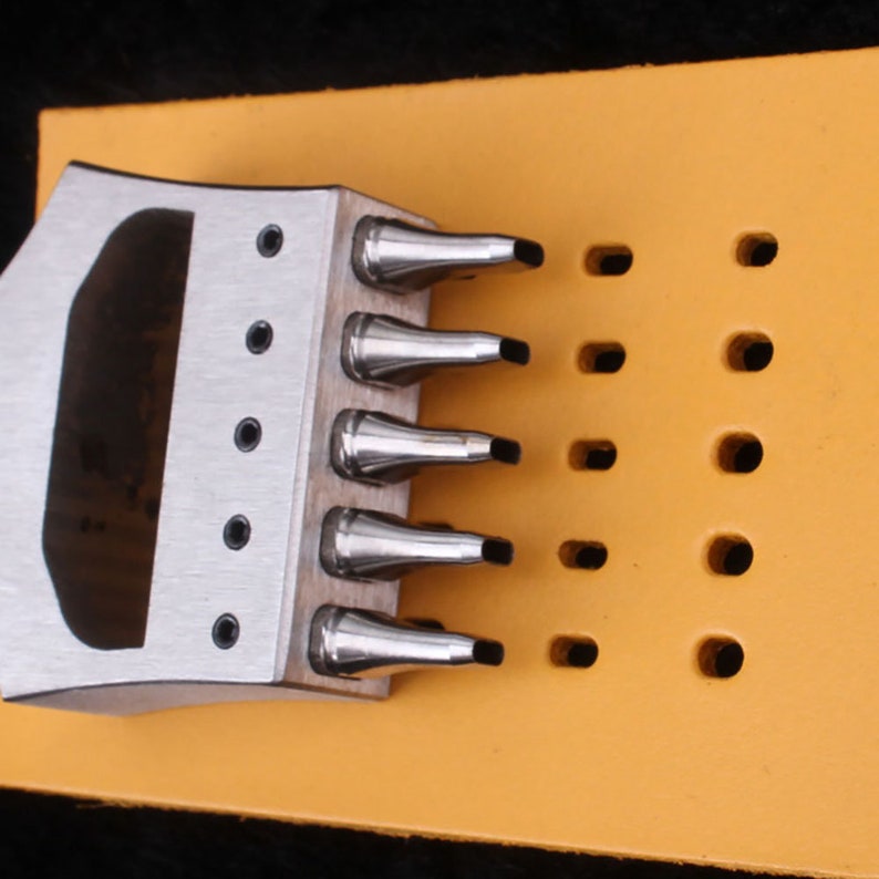

Here's a pic of one I found on the net.  I have some I've done but don't have access to them at the moment.

I did not use a round hole at the end.  What is the proper tool for that?  Can I use an awl or do I need a single round stitching punch?
I just use a scratch awl.  Give it a try sometime and see if you like the technique.  No right and wrong here, just likes and dislikes.

They also make a template which helps to mark the location for the holes.  Or, better yet, make your own.  Clear plastic works great for this.
thanks for the tips.  I ended up ordering a strap hole punch as suggested above.  No more guess work.
Looking good. Regarding the buckle pin holes. Buying strap punches can be nice, but if you do a lot of different sized holes and oval, maybe square holes (like for a Bell&Ross) it can quickly get expensive. So let's say you or someone else here start selling straps, and maybe you only make 1-2 straps for Bell&Ross/year, it would make more sense to buy a single punch.
And what is the best solution? in my opinion to prepunch the template, and press your hole punch through the holes in your template to make a small indentation, remove template and align to the indentation and punch.
