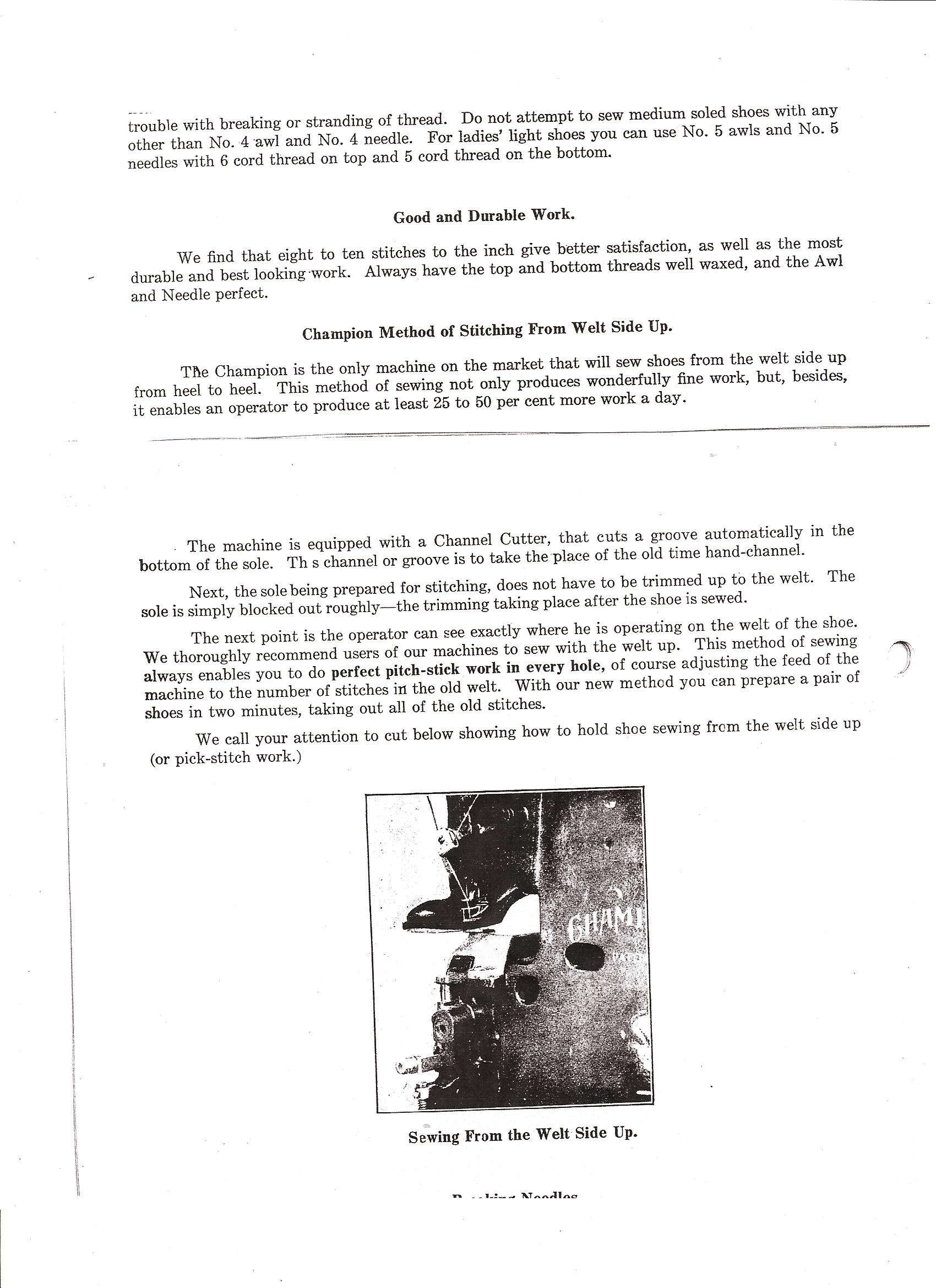

The Champion might do it as long as it still has the correct throat plate on it with the
channel cutter on it.Years ago when we worked on these we always took em off because we were selling them as harness machines.
Parts are real hard to find for these.
Bob
