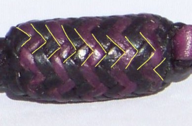

The one above the Spanish ring knot. It's just that the 'V's are tending to wrap around the knot. Too late to adjust it. Best done when the knot is being tightened. No worries, though. The whole thing looks really fine. :)

He is talking about the end by the popper vs the end by the ring. The long pineapple the Vs are not in perfect alignment, I wouldn't have notice if Hedge hadn't pointed it out and I looked close.

smart a**...LOL....I'm going to have to get a closer look at that knot. I knew what knot he meant but I can't see what Hedge is seeing, and I want to see it!

Maybe this will help. :)

There ya go!!! Bingo. I get it now. Thank you very much, to be honest I've never give that much thought, now you are going to have me making sure my turks head is all in alignment, cool! That's why I love this site!

In the first project. Referring to the bottom Pineapple Knot. Sometimes from my own experience, I have found that if the core underneath the knot is out of balance, or not properly shaped it can cause those misalignment's like you see with the V's. I have noticed with my own trial and error that the core can cause that kind of problem. Especially if you're using the waxed seine twine to build up the core to the shape you want. I am thinking that this is most likely what happened in that particular instance. But I have been known to be totally wrong.
You could very well be right knothead. Even though that piece is just a key chain I really wanted a quirt feel to it so it's wrapped in waxed string and rolled until I thought it was nice and smooth, then back braided a bit and then rolled again. I could have missed something that threw off the shape a bit. I have a 12 plait real quirt in progress right now, I haven't been about to work on it in over a week but I'm hoping to avoid the same mistake.
