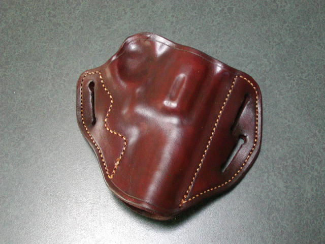

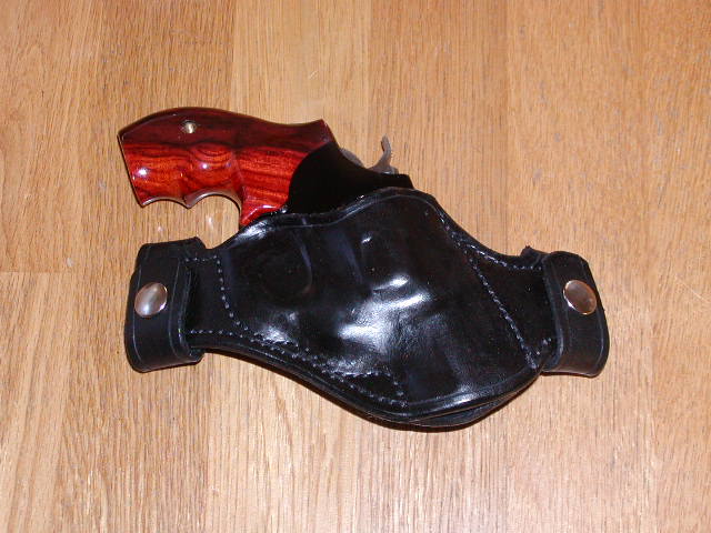

Lobo Posted June 25, 2009 Report Posted June 25, 2009 (edited) Here are a few that I have done recently. One is a pancake-style set up for dual-carry (strong side or cross-draw). One photo shows a pair of holsters for N-frame S&W revolvers, modification of the Avenger style with belt slot and tunnel loop on the back side. One is a snap-loop attachment for a J-frame S&W without hammer shields, set at a rather extreme cross-draw angle. You mentioned maintaining the angle during wear. This is best done by making sure that the holster's attachment points (slots, loops, etc) are formed to fit the belt being used. This stabilizes the holster on the belt and prevents shifting of the holstered handgun during normal movements of the body. Hope this helps you. Edited June 25, 2009 by Lobo Quote Lobo Gun Leather serious equipment for serious business, since 1972 www.lobogunleather.com

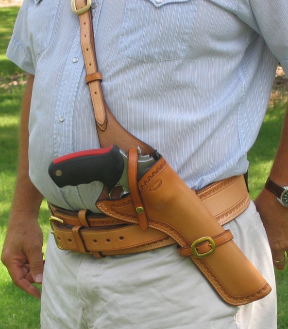

Members Go2Tex Posted June 27, 2009 Members Report Posted June 27, 2009 Did somebody say "cross draw"? Check this out ya'll. It's made for a .454 Casull. Obviously, I didn't make it to fit me..... Quote Brent Tubre email: BCL@ziplinkmail.com
Lobo Posted June 28, 2009 Report Posted June 28, 2009 Did somebody say "cross draw"? Check this out ya'll. It's made for a .454 Casull. Obviously, I didn't make it to fit me..... A lot of handgun there! Takes a lot of leather, put together by a skilled craftsman who understood the requirements. Nice job! Quote Lobo Gun Leather serious equipment for serious business, since 1972 www.lobogunleather.com
Members Tac Posted June 28, 2009 Members Report Posted June 28, 2009 Did somebody say "cross draw"? Check this out ya'll. It's made for a .454 Casull. Obviously, I didn't make it to fit me..... Wow, that is a beautiful rig! It looks well designed to.... Obviously for larger hunting pistols, but I have a couple in the collection that would work well in that type of rig. -Tac Quote -Tac "Well, I guess we did our good deed for the day Mayor"-Wyatt Earp "Tombstone"
