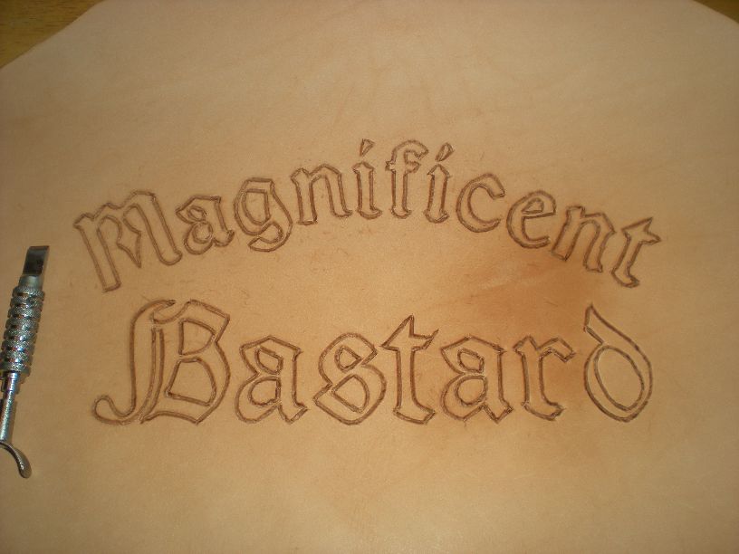

Here are some pictures of what I'm working on. I'd love to hear any tips you can give me.
After the initial carving:

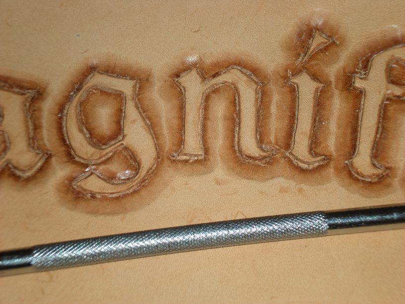

A progress shot:
I'm having an issue with tooling marks. I'm trying to blend them and, in some light they are, but then in another light they show up like crazy. What can I do to smooth those out?
  • Contributing Member
A modeling tool can be used to smooth out some of your beveling marks. In a situation like this, I would just slightly wet the leather before starting to work with the modeling tool. I will just dip my finger into some water and dab it on the areas that I am going to work on. With the leather just slightly wet, the tool wont make deep marks into the leather, just smooth out the surface. Use of the smooth figure carving matting tools around the letters would make them stand out a little more. Use of a checkered matting tool would also help to hide some of the beveling marks. You've done a very nice job carving the letters, and the beveling isn't that bad. You just need to learn to "finesse" your work. If you learn to strike the beveler with even pressure as you are going around the letters, cleaning up will be easier. Running the beveler back over the uneven areas can also help hide the tracks. Hope that gives you some ideas to try.
Posted (edited)
I could be way off as Im not good at determing what causes stuff with leather alot of the time but it looks like you could be beveling when the leather is still a little to wet.
Take a piece of your leather your using and case it like you would, cut a line with the swivel knife and bevel that line, enough to get a good example, then let it dry some more, come back and repeat. Do this a few times as the leather dries and see if it improves your beveling. If you find a spot where it seems to smooth out easier then you know you found the right dampness to tool it.
I know when I first started I allways started tooling to early. The leather would mound up on the edges of the beveler and was a pain to lay down because there was too much water in the leather. I gradually learned to hold off longer till I started and it made a world of difference.
