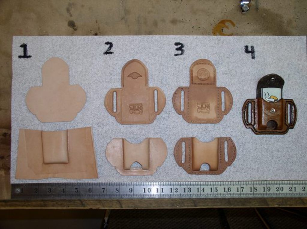

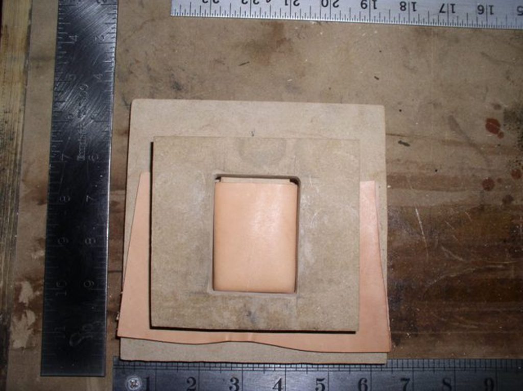

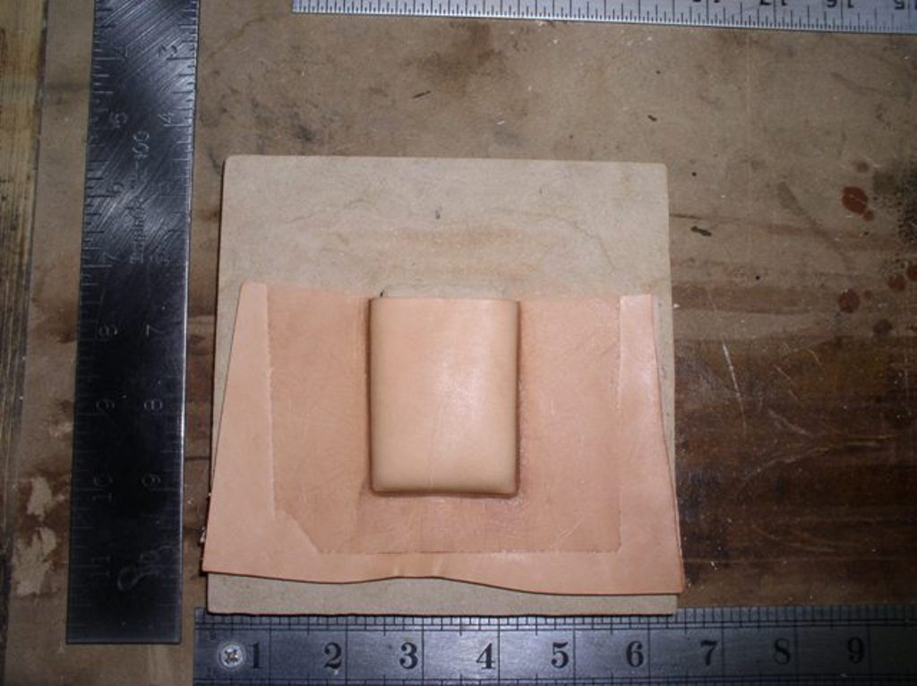

The Leatherworking handbook by Valerie Michael and the Making Cases 3 book series by Al Stolhman are a good starting place for mold making. Basically wood or some other shapeble material is used to make a form the wet leather is shaped to and held in position until dry. Here is a simple mold I made to form a case for a zippo lighter.

I cut them out of MDF with a jigsaw, screwed the one block (cut to the size and shape of a zippo) to the other and plugged the heads with leather. The whole contraption is held together with C clamps overnight after putting the wet leather piece in it.
