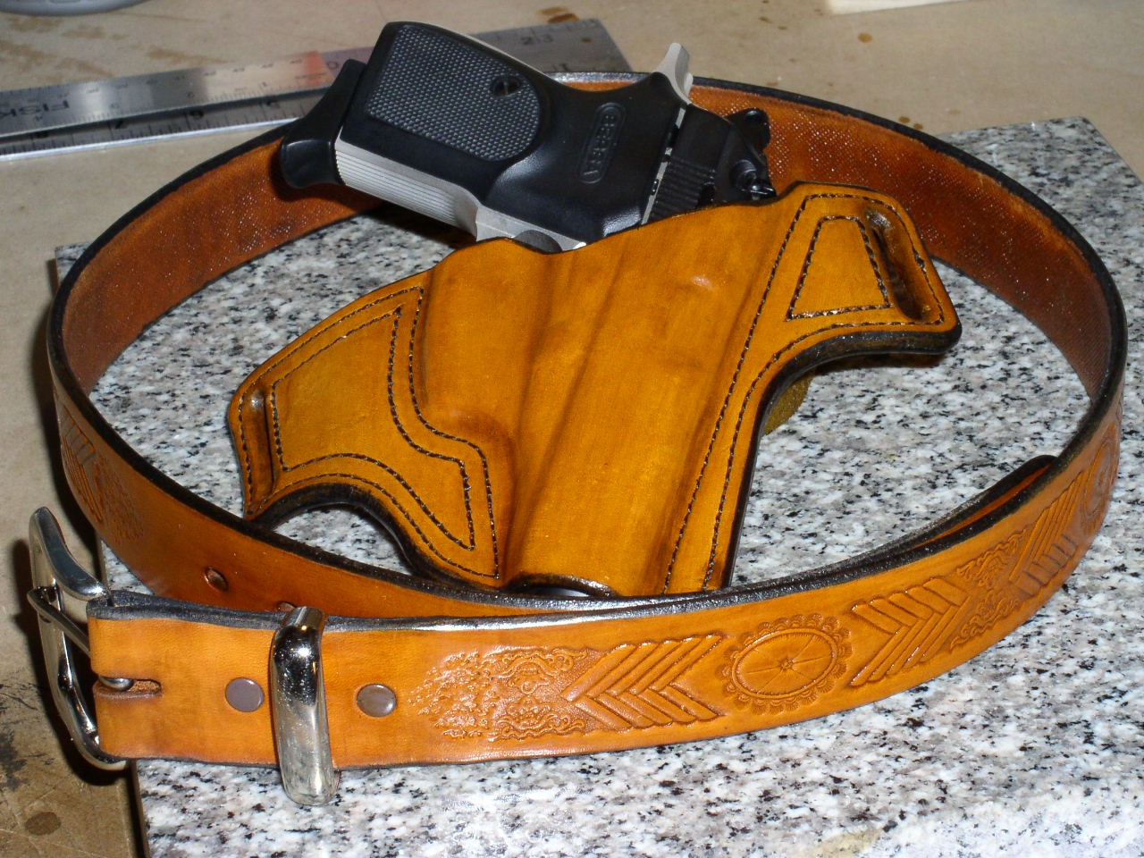

If you do a search there are other threads that address your question. In reading them I found that it is possible to damage a firearm with too much pressure. The butt area where you slide in a magazine is vulnerable as just a slight bend will not allow smooth extraction or installation. I have used vacuum food saver machine with good results other than a slight diamond pattern of the bags being imprinted into the leather which does smooth out most of the time with boning And a dummy gun is a good way to go unless they do not make the correct model. Some have made wood molds also but I am not a carver so I haven't tried that yet. This one I did for my bersa and made a belt to match awhile back.
