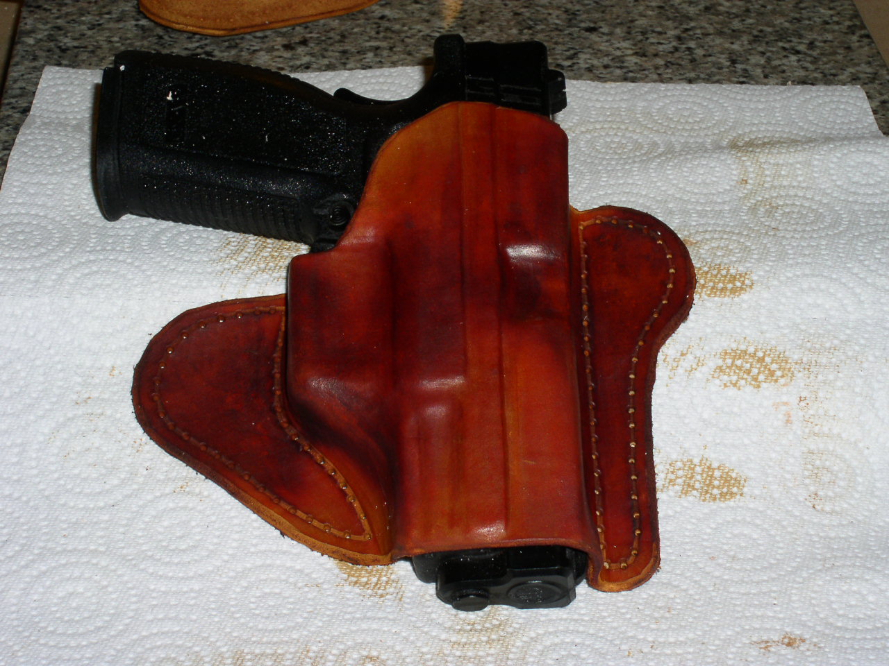

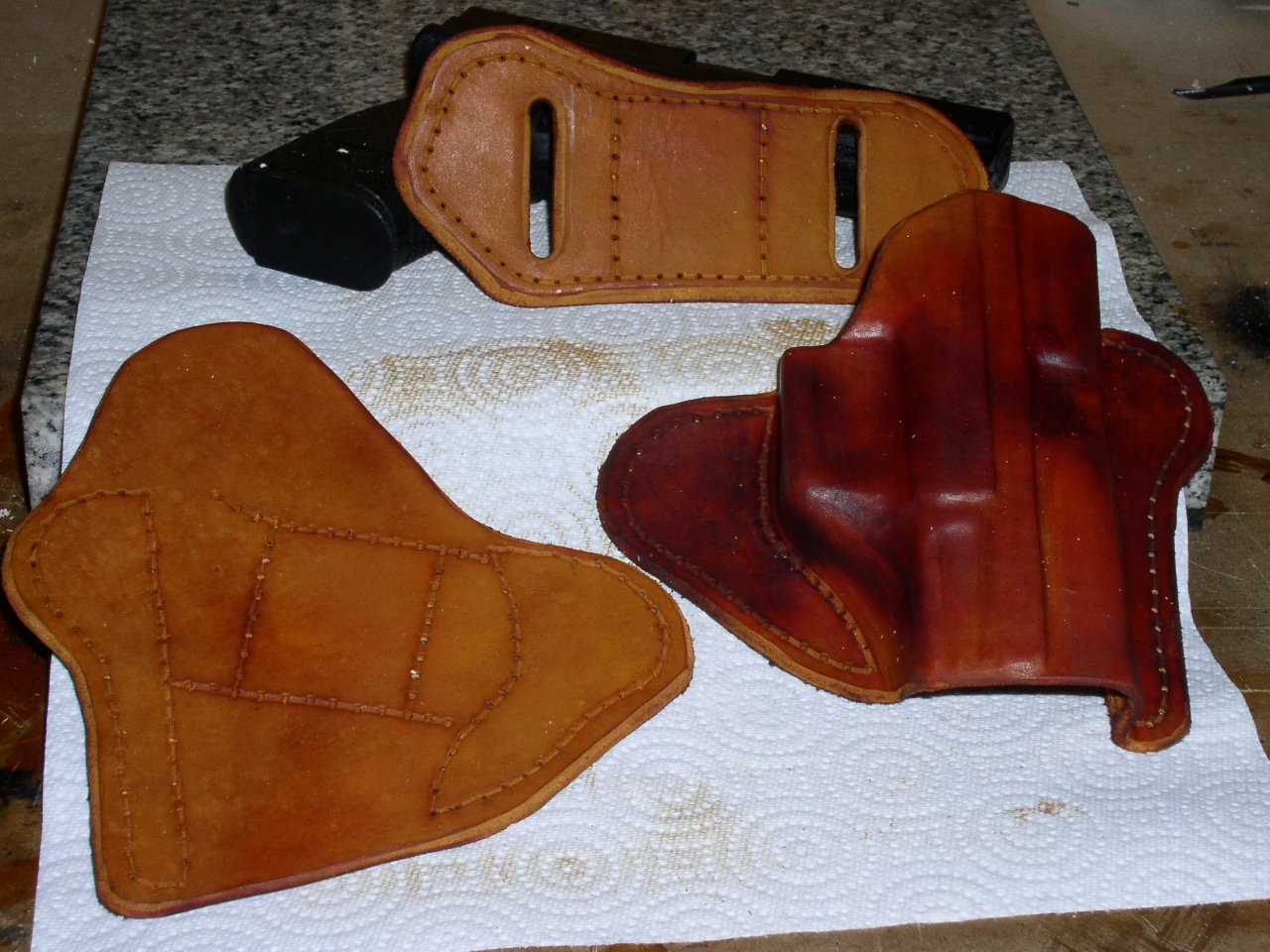

XD is a very thick gun so I also am having some trouble getting it to look right. If I can I will try to post a couple of pics tomorrow, I made it with 3 parts but havn't sewn it together yet. 1. front is moulded over the gun 2. A flat back piece including sweat/pinch shield. 3. A strip sewn to the back with slots that allows the belt to exit between the back and the strip so slots are not seen from the front. I am not sure if it is going to work at this point it may be too bulky but I used scrap so it didn't cost much. As far as the shape I just played with scissors and paper until it looked right to me.

pics
DROF99....HERE'S MY FAVORITE STYLE OF CARRY HOLSTER...I MADE THIS HOLSTER ABOUT 8 YRS AGO..IT'S VERY COMFORTABLE AND SECURE..I CARRY IT DAILY, ALL DAY LONG....WHEN I GET MY PATTERN THE WAY I WANT IT, I TRANSFER IT TO POSTER BOARD AND LABEL IT. THEN I FILE IT IN MY PATTERN DRAWER FOR FUTURE USE...
