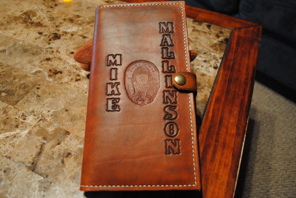

After spending 1/2 hour trying to figure out why the aerostitch would not tension right, I got it going. Haven't used it in a while and I didn't notice the thread had slipped on one of the tension wheels. I did this one a little different: Done all stamping after casing. The badge is not too visible. I had Jeff at Gray Ghost Graphics make this. It takes about 3 tons of pressure to get it this way. I then put a coat of neats foot oil on and let it dry, then dyed with medium brown. Done the stitching, and yes I need to practice more, then a coat of Aussie for the final coat and buffed. I was pleased with the color and so was the customer.

Nice work Bill, looks like you have the stitching down now,,good job Bill .....
