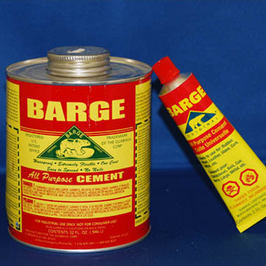

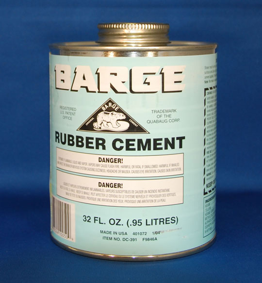

dirtclod Posted October 21, 2010 Report Posted October 21, 2010 Here are the labels. The red and yellow can is the all purpose cement and the green looking lable is the rubber cement. Quote I'm old enough to know that i don't know everything.
