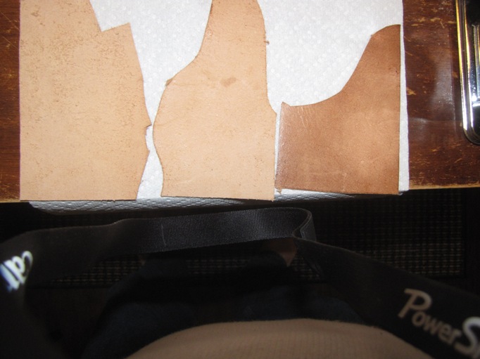

here is a pic of some samples. Left to right untouched leather.....rolled leather....cased and rolled leather. it did not really gain any more in width.

Here is a pic of the leather. From left to right......stock leather.....rolled leather.....cased and rolles leather

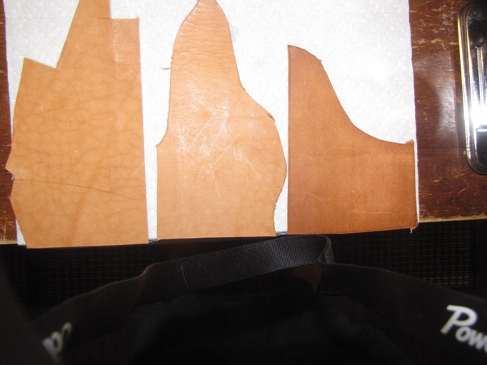

it did not cut the leather....it compresses it. Nice part is it burnishes the backside and makes the grain tighter on the front side.Did the pasta roller skive the leather or smash it? From what I am reading I am leaning toward smashing it.... thats alot of pressure the roller is applying if it is smashing it.
frontside of leather
backside of leather again left to right....raw leather......rolled leather .....cased and rolled leather

I am glad it worked for you. Seems to tool better too.....grain seems to get tighter.
