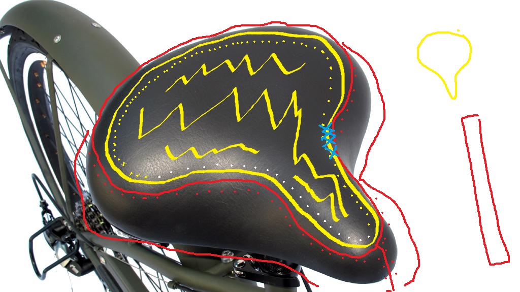

Seat: The saddle I have on there now is triangle shaped as shown below. Its just vinyl over some foam stappled into the plastic seat pan (if you can call it that?)
Option 1: Tool my design in leather cut to a shape closely approximating the vinyl already there. Staple or rivet that piece as I wet from to the saddle.
Option 2: Try a laced version like many of the solo seats shown in this forum. Looks to be more difficult, and not sure if it would work as well with such a 3D saddle shape. I've never laced before either.
Option 3: Something cool that you forum members suggest to me..

OK so here goes. my feeble attempt to describe what I'd do. cut out a "top" illustrated in yellow. make it so it's not quite to the edge of the seat. tool design and punch holes for lacing around a 1/4" from tops edge and spaced for type of lacing. next cut a strip wide enough to go from the top and wrap under the bottom with enough to staple/rivet to the pan (looks like around 3-4" wide) and make the strip (the side) long enough to go around the seat and make the seam either in the front or back your preference. (red) it's a bit tricky to get the side lined up with the tops holes but I usually make a few holes at the seam end and start lacing and make more holes as I go. if you make the side this way it's much easier to wet form because the side is already mostly shaped to the contour. that deep contour at seat back and horn is hard to form otherwise. don't laugh at my crummy sketch

oh and I find if you make a top and lace a side when you have to wet from you only have to wet the side leaving the tooled top dry and undisturbed
Edited by Scary Leatherworks
Yayou got it...I would suggest one more thing...Make the wholes in the side strip first, then wrap and form it to the sides then place you top on and using a stylus or pencil mark how the whole are going to be on the top fro the sides...if you can get what I m saying....CBRTRSHR is right I am exhausted...I hope I am helping more than f'n you up right now...hahahah

Thanks for all the replies.
I'll admit I didn't quite follow all of the suggestions. So, let me consolidate my thoughts on what I took from the suggestions.
1. Trace top section, and cut out. Tool design.
2. Cut strap with about 3-4" of overhang.
3. Lace together sections of strap and top.
4. Attach whole thing to saddle wetting the sides, wet forming as I go. (Would you suggest Rivets or Staples?)
Is that about right? What type of lace would you reccomend. I gather that Roo lace is best, but also pricey.
