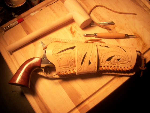

Here it is. Letme know what you think.
post-29616-009267700 1331866142_thumb.jp
post-29616-024211100 1331866166_thumb.jp
post-29616-097976100 1331866168_thumb.jp
post-29616-050429100 1331866172_thumb.jp
A little of Topic but your have some really good photography skills
Thanks.
Very nice from what the filter allows you to see, the filer kind of blends everything together.
Good looking though!
