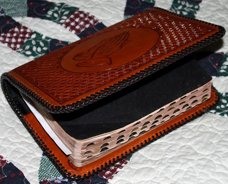

These are becoming popular. Great protection for a Bible.

Nice basket weave. Which tool did you use for the basket weave?
That is Very Nice Ken! Very Nice!
Very Nice lacing too! You really got that down!
...I really like that color... What did you use for that?
Thanks,
This was done with a craftool X501.
Ken
Thanks Cheryl,
I use this color quite a bit. I oil the leather lightly with Neatsfoot Oil, then I dye with Eco Flo Hi-Liter in Saddle Tan. When that dries I put on a good coat of Eco Flo Super Sheen let dry overnight and then use Eco Flo Gel Antique in Saddle Tan. I let dry several hours or overnight then it gets two coats of Tan Kote.
Ken

Thanks for sharing your dying/finishing recipe…
Eco Flo Gel Antique Saddle Tan and Fiebings British tan are my favorite colors presently.
What you get with your products is soooo nice! I really like that deep color.
Thanks again for sharing

Thanks again, nice of you to take the time to post encouraging comments.
