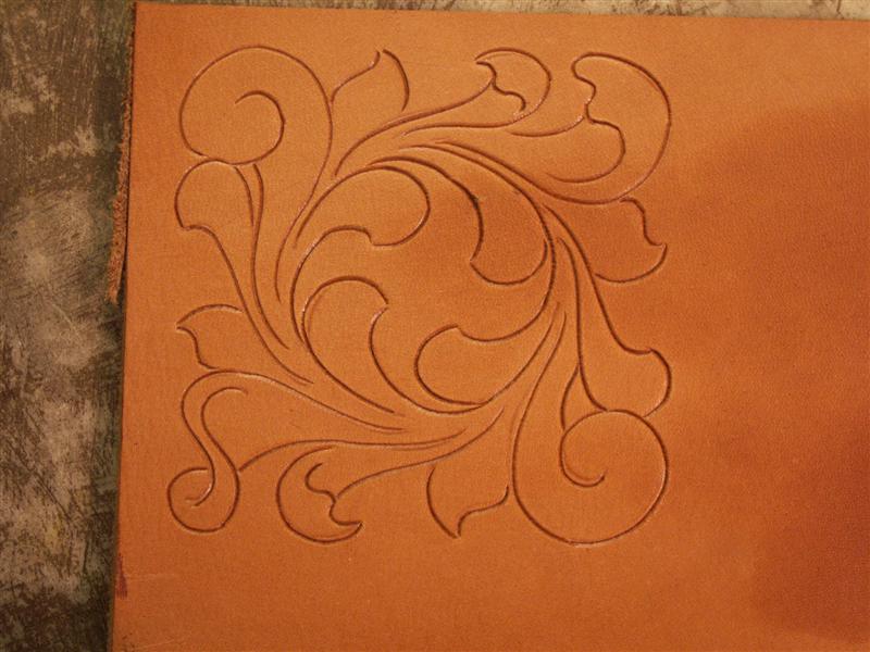

Johanna says things are fixed and we can post pictures again. I am going to start with this short How To. I am working on an in depth one on figure carving too, but want to see how this one goes first. These pictures show how I carved a simple floral pattern. The first picture shows the pattern carved with the swivel knife. You can see that where cuts meet, there is a small gap, the cuts do not meet. Where cuts end, try to lessen the pressure on the knife, letting the cuts fade out instead of ending abruptly.

Is that the correct order of tooling, I'm always confused about which tools to use in what order. I usually start with the beveler (after the swivel knife) around the outside of leaves and scrolls. Then pear shader, camo, veiner, seeder and then bevel the inner areas of leaf and scrolls followed by background.
Clay, Great job! As far as order of tool use, I believe Paul Burnett suggests that the blunter tools like a pear shader be used before the sharper tools. He establishes his order with the amount of dampness in the leather. However, like you, I also do beveling first.
I would like to add one thing that may be pertinent in the use of the camo tool along the outside of the scroll. Some one once told me (I can't remember who) that the inside points of the camo tool should be pointed at the imaginary center of the scroll. Thus, the tilt would gradually be dimisheded as you go up the scroll. Carlb

Usually I do it the same way you do, bevel after cutting, then cam, veiner, etc. But that is the way that Jim has been teaching it in his kids classes. It does seem to work better that way for certain things. It's just hard for me to change the order that I have become used to doing them. I think back when I started, by beveling first, I could understand the pattern better. By using the cams and shaders and vieners first though, you seem to get better definition in your patterns. Maybe someone else can better explain why.
Dave there is no correct order. I switch depending on the design and the effect I want to get. I will often bevel before I pear shade so the shading can move into the bevel but not always. What you want to think about is what is on top of what,and where is the stem or the line of flow. As you do some tooling you will learn which tools will help hide the mistakes you may have made with the previouse tool and that will dictate the order you use after you focus on the main flow line and what is the closest to you. Play on scrap and feel free to mess up.

Thanks for confirming my suspicions. :spoton: I've been learning from Al Stohlman books and his various books seem to vary as to the order of tooling too. So as you say...there is really no correct order.
