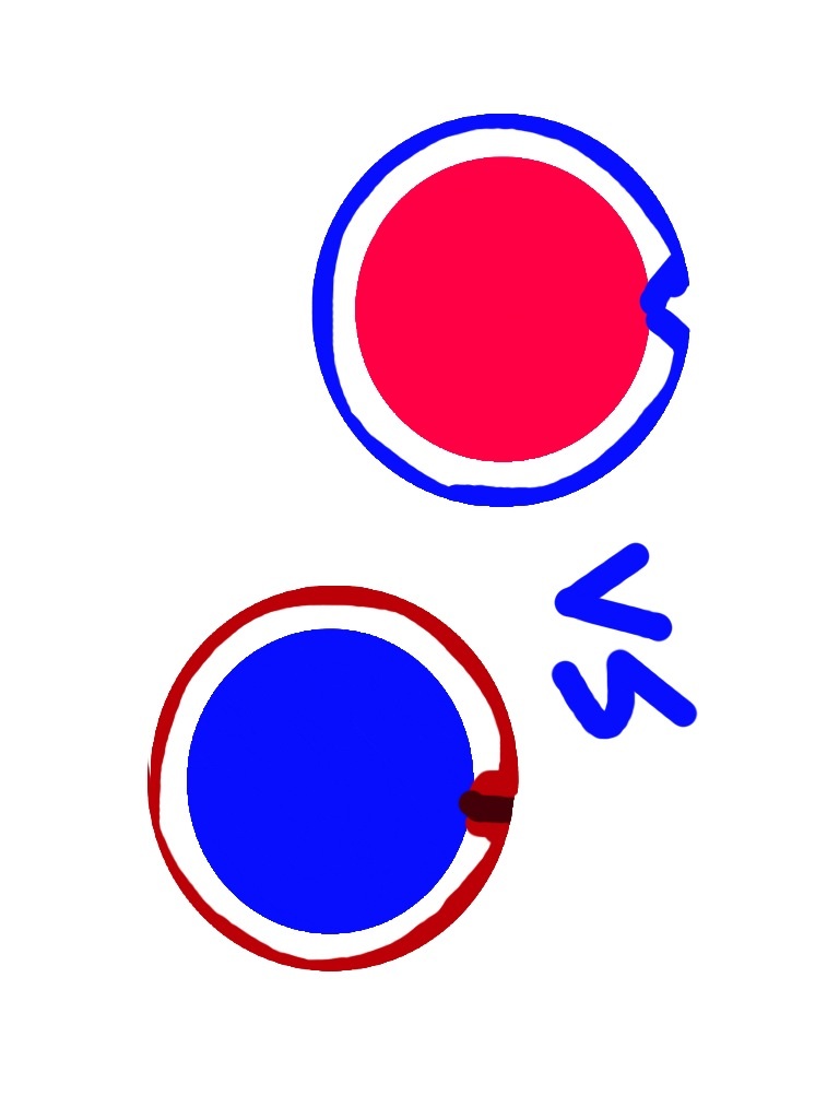

Members RiverCity Posted March 29, 2013 Members Report Posted March 29, 2013 Are your edges cut at 90 degrees? If so the inside part of the seam is touching and not allowing the outside to meet up. Your edges need to be beveled inwards. Imagine a pie slice. Hope this helps Chuck Quote
Members RiverCity Posted March 29, 2013 Members Report Posted March 29, 2013 Sorry for the crudeness of the drawing Chuck Quote

Members Dwight Posted March 29, 2013 Members Report Posted March 29, 2013 Another thing you might try, . . . sleeve it with "ideally" a piece of thin sheet metal and some radiator clamps. My wife had a project that needed covered, . . . and it was not until I sleeved it in the thin aluminum that I was able to get mine done, . . . which was lacing it from top to bottom. If thin sheet metal is unavailable to you, . . . perhaps plastic or even cardboard, . . . just be sure to wrap it so that seam on the sleeve is on the opposite side of the cylinder than the leather seam, . . . and be sure to follow River City's idea, . . . otherwise the inside edges will not allow it to come together. May God bless, Dwight Quote
