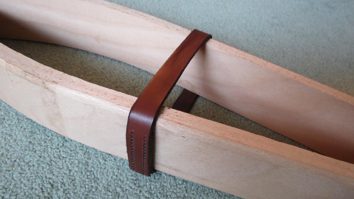

Have you got a picture of how you attached loop that you made ?

This photo shows the stitching pony I was using and my recently purchased stitching clam with the leather and loop that I added on my own.post-33768-0-94247900-1367666603_thumb.j This photo is a close up shot of the leather loop that I made. It simply slides up and down on the clam to tighten or loosen the jaws. I really like this method and take no credit for it whatsoever. post-33768-0-54338000-1367666753_thumb.j. To make the loop, I just cut a strap off of a piece of scrap bridle leather I had, cut it to what I thought would be a good length, glued and stitched it together. Nothing fancy, for sure but it sure does work for me. Hope this helps.Bob (sorry for the "screwy" positioning of the photos - haven't quite got all this tech stuff down yet)

Thanks for those pics really appreciated. As they say a picture is worth a thousand words ;)
That's the stiching pony I have. I am deffinaltley getting the stiching clam makes the stiching pony look like a toy. The loop idea is brilliant, so simple and does the job!
Thanks again for taking the time to post the pictures really appreciated :)
