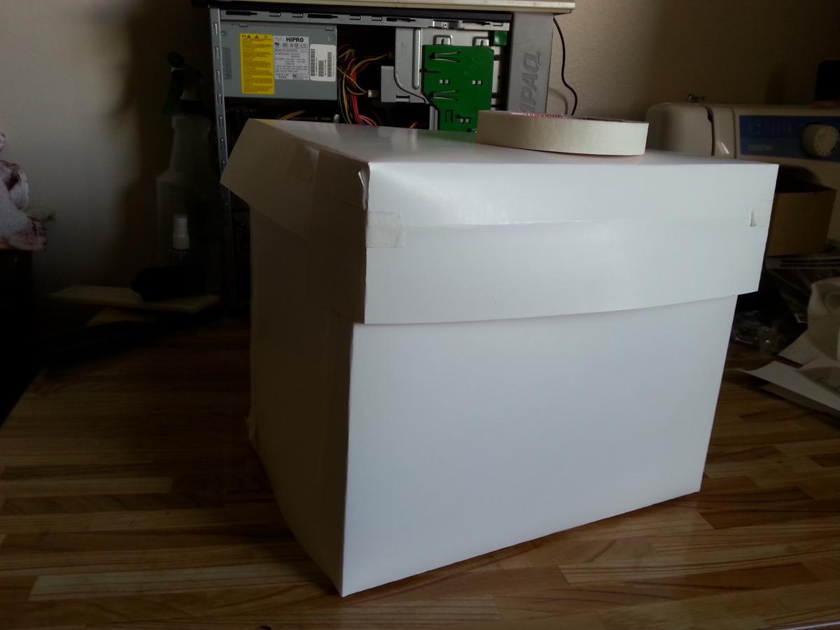

So, I was commissioned to make a "commuter bag" for a friend that will carry her lunch bag, a travel mug and a book. She's just started taking the bus instead of her car and didn't want to carry multiple bags on the bus
First picture is a bristol board mock up (I find it easier to have a template to work from then trying to cut things with just a ruler and square) This allowed me to lay everything out on the leather as well so I didn't waste or have to buy extra

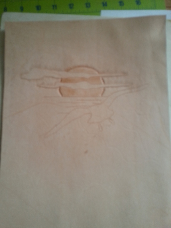

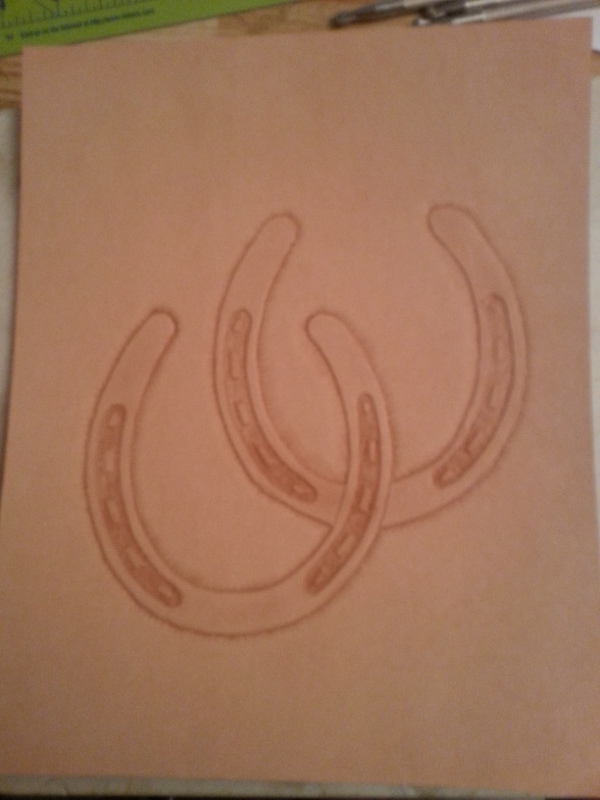

2nd and 3rd pics are the carving work done for the end pieces
I used a single layer of resist on the moon and parts of the horse shoes to prevent the dye from sinking in when I dyed it

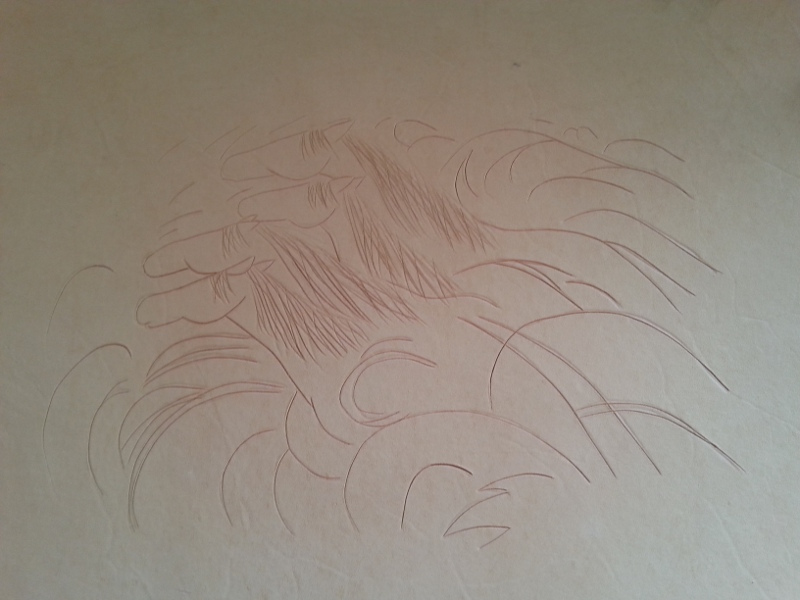

4th pic is the custom artwork done on the front

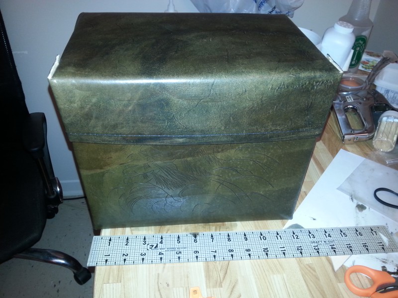

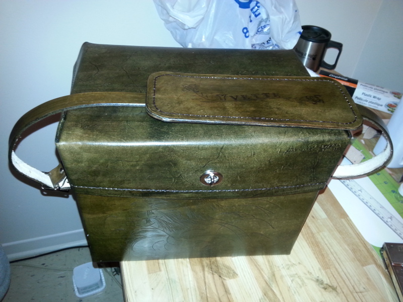

after most of the main construction and dye work
post-44641-0-57769800-1386430059_thumb.j

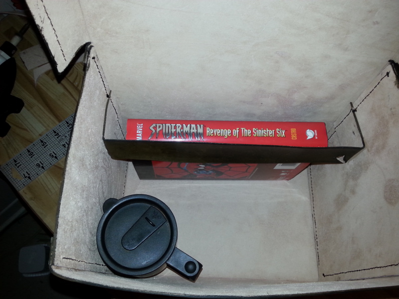

almost finished :)
inside view of the bag. All inside pieces are sewn into existing seems to hide them

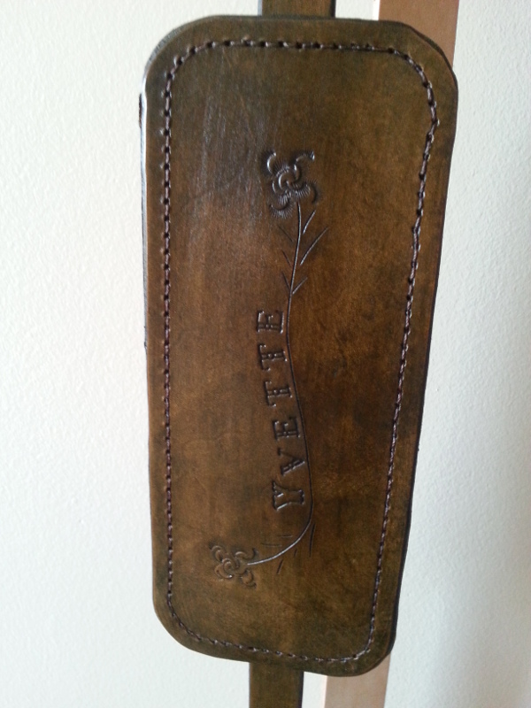

strap pad on the carry strap. Edges have been slicked and 1 coat of resolene applied in a 50/50 mix

the finished product
