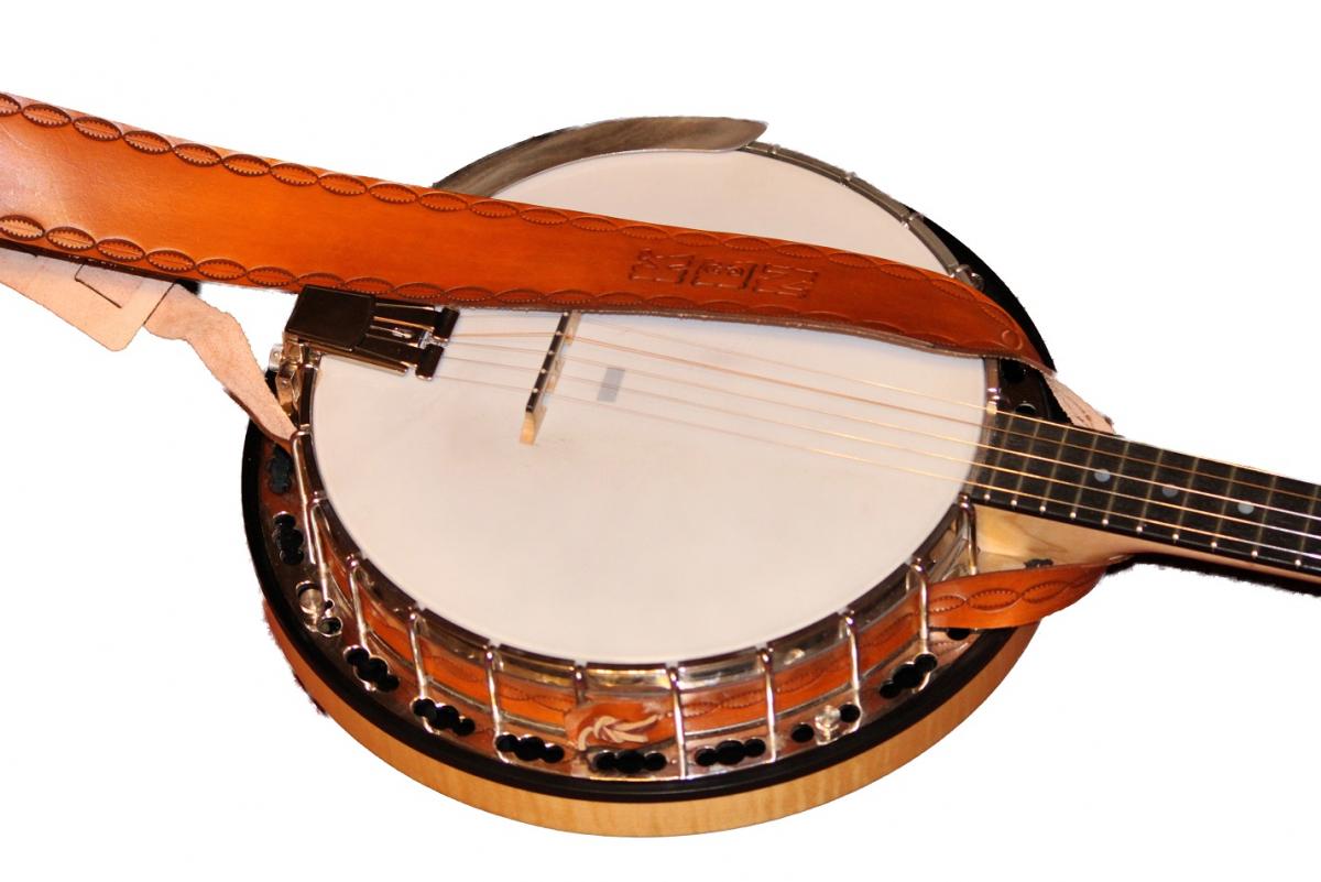

I have a template for a cradle type strap and an attachment type strap, I had them made into an Acrylic Template by Joyce at Black River Laser. I have the diagrams I sent her and will send a pdf of them, you can make it by using a 2-1/2" strap and cutting it to the specs in the pdf. It will take me a little while to put the measurements on the pdf. You need to know which strap she wants, an Attachment Strap works on any Banjo and can be easily removed to put the banjo in the case, a cradle strap is desired by high end banjo players, ie. Gibson, Stelling, Deering (not the goodtime), Huber, etc. Most imported Banjos including Fenders don't have the clearance under the j-hooks to attach a cradle strap and it cannot be easily removed and is stored in the case with the Banjo. Some folks don't like storing the strap in the case. I'll post directions for both.
Chief
Here is the pattern for both kinds of Banjo Straps. I annotated it as best I could to assist you in measuring out the strap. I use Hermann Oak, 2-1/2" straps split to exactly 6oz. I buy a 2" strap as well for the back piece and have it split to exactly 6 oz. You can buy them in the 6-7oz range if you like, I like them completely consistent throughout the strap. If I'm going to line the strap, I replace the 2-1/2" strap with a 2-1/2" strap split to 4oz and a 3" strap of 2-3oz for the liner. I get them from Springfield Leather and they charge me $1.00 each for splitting the two straps so that adds to the cost which I pass on the the customer. Unlined actually works better in that it drapes much better and is easier to get in the case. The 2nd and 3rd page of the PDF is a diagram of how the two different straps attach to the banjo. For the cradle strap I tie them off with leather shoe lace material and I use Chicago Screws on the attachment type but the customer has to either get an attachment kit from a music store or 3/4" plastic snap hooks for the other type. Let me know if you have any questions. I'm enclosing a picture of each type of strap as well as the pattern.
