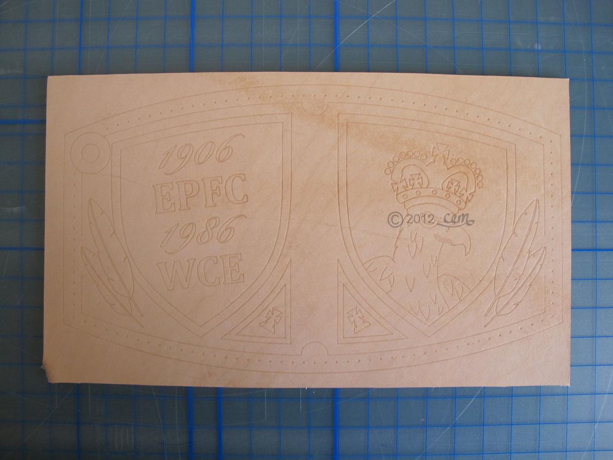

I have used Shapeways and for small stuff 3D printing it's great if you want to do larger tracings though say A5 and above another idea would be to use a flatbed vinyl cutter with stylus attachment. As with the hobby 3D printers they can have a tendency to warp large modeIs, I plan on getting my own 3D printer sometime for smaller stuff but don't have the space for one at the moment.
For larger tracing designs I'm currently using a Klic n Kut Maxx www.knkusa.com here is an example of the tracing it can do, it can trace directly onto leather up to 12oz thick.

Brilliant cem! I am in the wide format priting business and it never occured to me that a vinyl cutter could cut diretly to leather. Although we don't have an vinyl cutters we do have a Mimaki kiss cutter which should work. But I may look at one of the small cutters for my workshop.

I'm a little unsure as to what you want to do as sometimes the terms are a little different between Australia and the US ie are you wanting to draw a design onto leather like what I showed in my picture, cut the design with a knife for bevelling or make a craftaid (tapoff) to be able to push the design into the leather or even actually cut the product pieces out. If it's the last one the knives aren't big or strong enough to be able to that on the small hobby cutters.
Your Mimaki cutter should work for design tracing as long as it has flat tables attached front and back, it may work work without them but I can see the stylus possibly going out of alignment due to the weight of the leather hanging over the edges.
