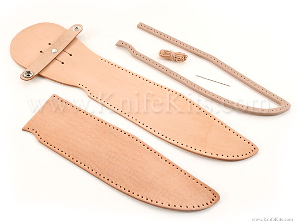

Members DJole Posted May 24, 2017 Members Report Posted May 24, 2017 This is a pattern of a typical welted sheath design, borrowed quickly from Google, which uses a strip of leather between the front and the back to protect the stitching from the sharp blade edge: From what you say, that's what you're doing, which is pretty standard procedure. Adds a layer of difficulty to the stitching, but makes the sheath last longer. I can't say that using a straight pricking iron as a chisel is a no-no. It's probably an aesthetic thing in this case. My (limited) understanding is that the angled stitch is less likely to tear through the leather, since it grabs more leather or something. But on a knife sheath, with heavy leather like this, it's probably a matter of how much time you want to spend stitching (or what the patron wants) rather than wear and tear on the stitched line. Quote \D. Jole \ --> <http://djole.altervista.org/djole/Publications/Leather/Lindex.htm>
Members WastelandOuterwear Posted May 24, 2017 Author Members Report Posted May 24, 2017 2 minutes ago, DJole said: This is a pattern of a typical welted sheath design, borrowed quickly from Google, which uses a strip of leather between the front and the back to protect the stitching from the sharp blade edge: From what you say, that's what you're doing, which is pretty standard procedure. Adds a layer of difficulty to the stitching, but makes the sheath last longer. I can't say that using a straight pricking iron as a chisel is a no-no. It's probably an aesthetic thing in this case. My (limited) understanding is that the angled stitch is less likely to tear through the leather, since it grabs more leather or something. But on a knife sheath, with heavy leather like this, it's probably a matter of how much time you want to spend stitching (or what the patron wants) rather than wear and tear on the stitched line. yea, I mean the stitching will be fine i guarantee that, but ya know it COULD be better... its still a thing that kinda bugs me and now that im looking at it im kinda annoyed i forgot to slick the holes where the braided cord is. Quote
