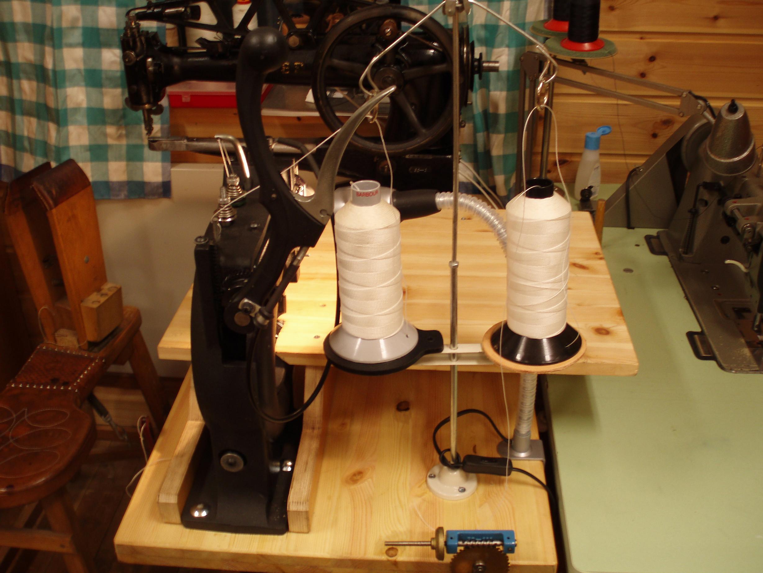

I have punched a hole (3 mm) in the foot of the spool, put the thread down through the center of the spool and then out through the hole, which keeps the thread to unwind upwards. You try it, it might solve your problem, a one minute job.
Have a look at the spool on the right.
/ Knut
