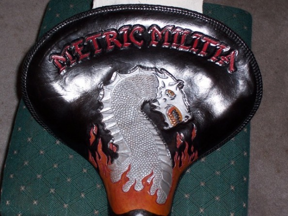

A Harley seat all colors except black field, done with Sharpie's and MagicMarkers.......
Very interesting, I would never have considered sharpies and markers. They give a very good effect! What finish do you use?
