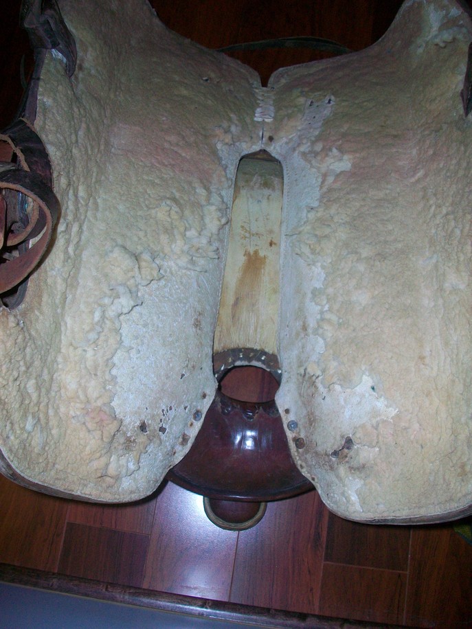

I took a picture of the underside of the saddle. Someone before me tried to replace some of the conchos, so I will replace all of them and the strings in the back. That is about the extent of what I will try to fix, I will have to take it somewhere for the fleece and a small repair on the back cinch. In my 25 years of saddle ownership, I haven't had to clean one up as much as this one needs, so my experience is more limited to oiling. Do you recommend any good soaps or cleaning products?
It is kind of a shame so much buildup got on it in the first place, but it looks pretty solid yet.

Glycerin soap is good. If you decide to have someone refleece the saddle you will have a choice of synthetic (no shrinkage) and genuine sheep skin/wool. Before anyone does anything to it inquire as to how the new fleece will be sewn and if the original holes will be used. I've seen them with new stitch lines and to me it devalues the saddle. My machine can be set to use the original holes.
