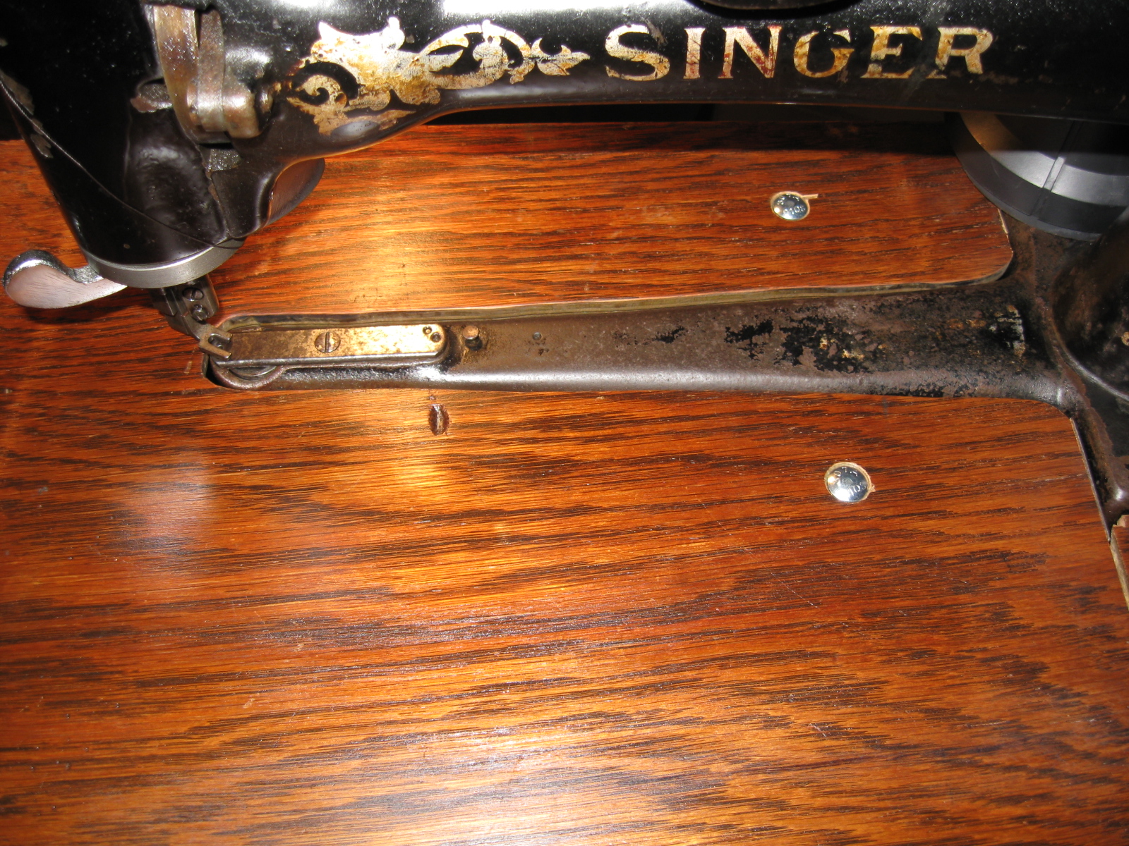

Close-up of finished work table
Close-up of finished work table, note the two carriage bolts on the rear of the "wings" of the table.... they lock the top down into the machine studs, and provide the secondary mounting which makes the table solid as a rock...! While still allowing the table top to be removed at a moments notice, to work on shoes & boots... or added back on to work tarps & flat work.
