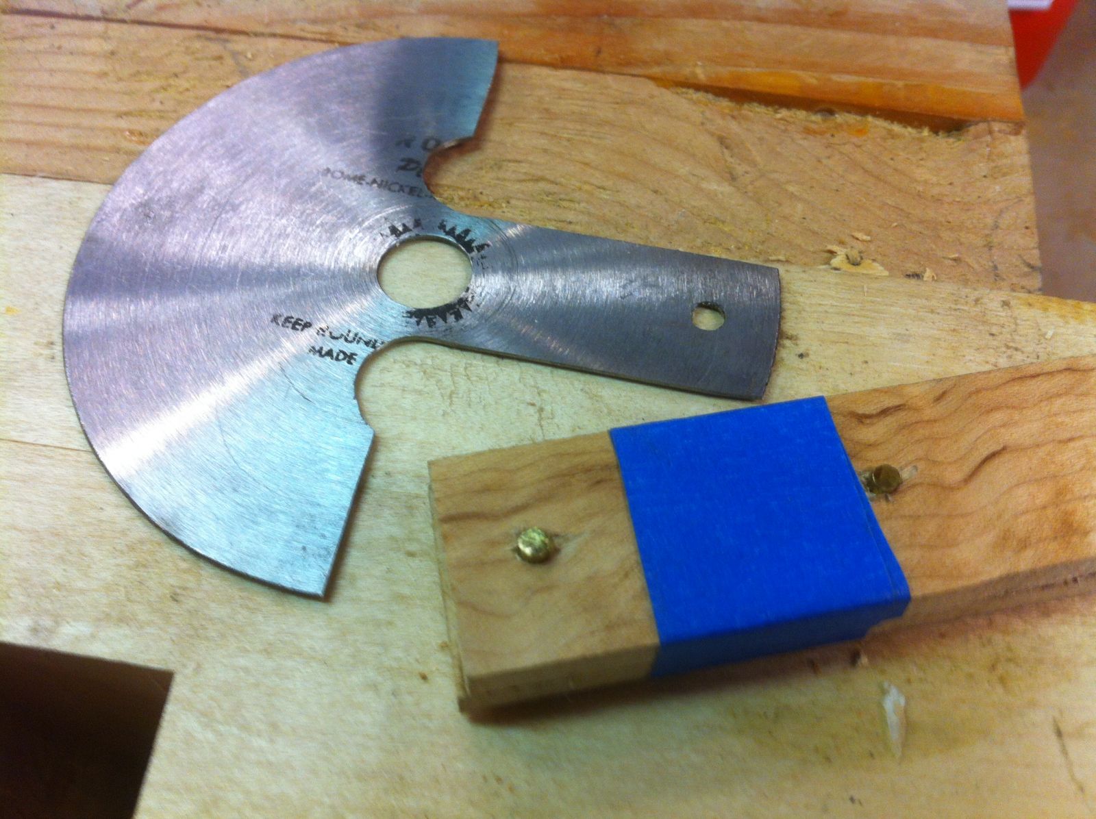

Pin the tow sides of the handle together
Shape the front handle temporarly pinned together. This is the easist time to shape the area the is over the blade area. Go to as fine a finish as you will want and you won't have to come back when the blade is in the way
