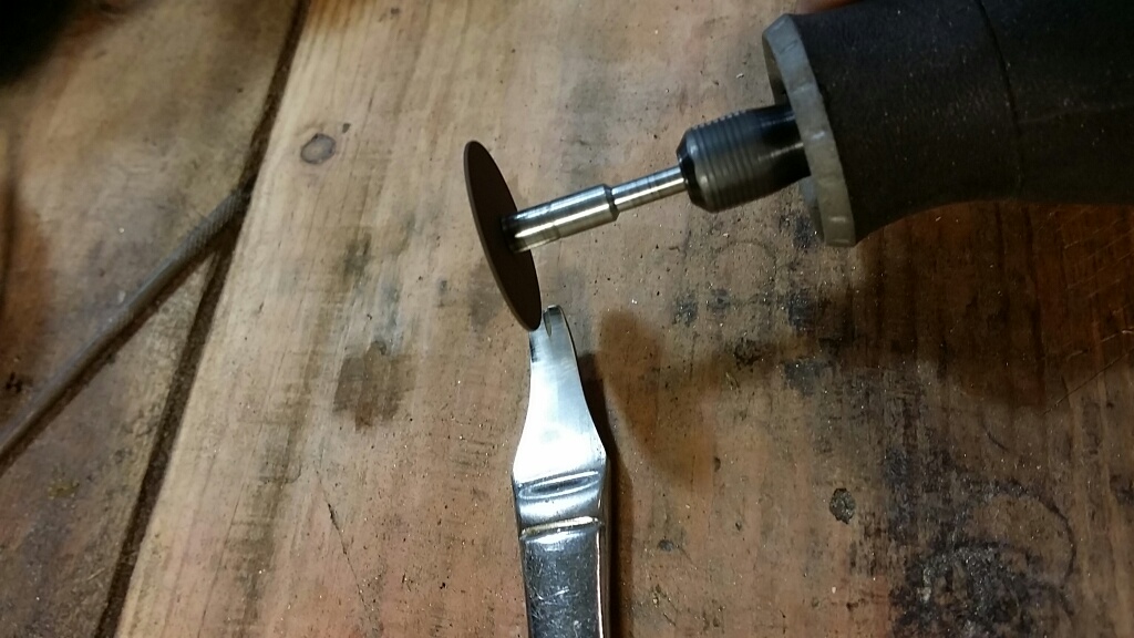

Beveler HowTo 10
I hold the knife to the table and rotate the cutoff wheel onto the blade. This gives me pretty good control. I run the Dremel on the lowest speed and take my time. The total groove length is 1/4' from the tip while the cutting edge is set back 1/8" from the tip. Carefully work the cutoff wheel from side to side to make a wider cutting groove.
