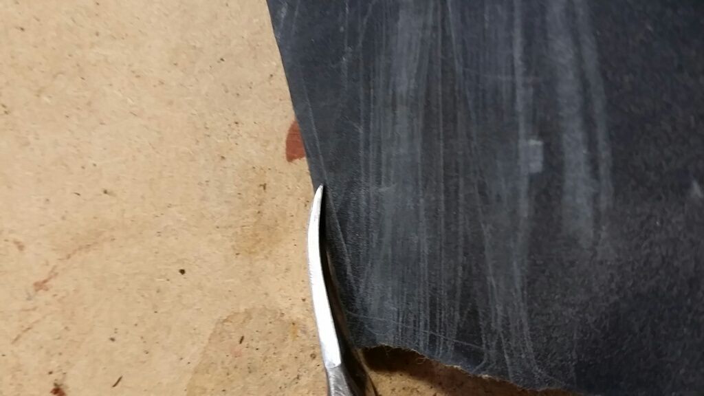

I use 800 grit wet/dry paper to tidy up the cutting edge and square it off. Note the angle, it needs to be like this so you don't ruin the cutting edge. After this I run it over my strop until it's shiny then I use a 1mm thread rubbed with jewelers rouge and strop the inside of the cutting edge using the same angle as used with the sandpaper.
