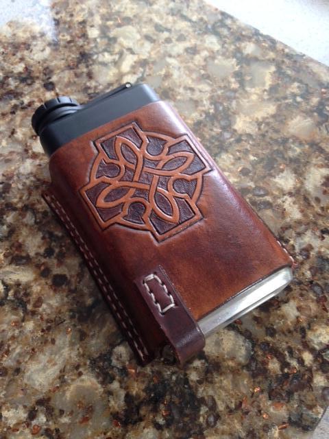

after the failure of the last flask holster i decided to try again. in order to avoid dealing with wet molding corners i decided to just remove them from the design altogether. I found about tandy's craftaids and thought i could do better than the celtic motif from the first holster. It just like painting by numbers!!
first time using the antique gel; should've applied more coats of super sheen as a resist. all in all, I like how the colors came up.
I wanted to have the holster sitting at an angle for a cross draw, but didn't think about the spacing needed for the bottom straps. originally I planned to have to bottom straps but the belt loop took too much space.
the main body has two rows of stitching for two reasons: 1. aesthetics and 2. I put the first row too far from the flask which made it very loose so I added the second row to increase the tension
