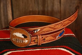

1 1/2 inch hand carved running leaf and feathers, lifted and painted. Fully lined and stitched

That is one sweet looking belt!
Thank you for the nice comment. I made this belt for my wife for her birthday. She likes the feathers that I do on various items. There are four feathers on the belt, placed where they fall between the beltloops, rather than under one or two, and the buckle is a brass oval with a 5 oz. oval inlay with two more carved and lifted feathers.

Very nice. What tool do you use off the main stem? I use a Rob Barr swivel knife like tool where I can insert Exacto Knife blades.
Thank You. I use a surgical scalpal. I get them from my vet. The blades are seperate, but come with a flat plastic handle. They are pretty reasonally priced, and I find they cut much smoother that the exacto blades.
