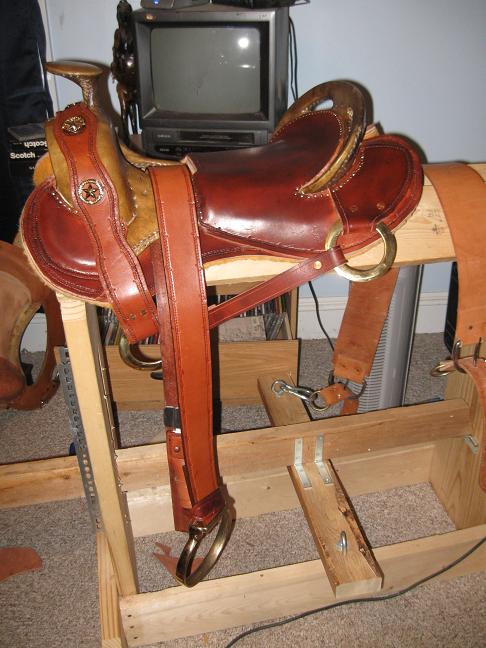

Built using Santa Fe tree. The saddle was built using a minimalistic approach for use on the trail. Seat was cut to be completely integrated with the skirt and hold it to the tree. Seat leather wraps completely around the back of the cantle and is sewn to the skirt to hold it in place. Since I don't cut my horse in two when cinching it up, I wasn't overly concerned with stretch. By the time I get done riding, I can usually fit a fist between the cinch and horse to give you an idea of how loose I ride it. Overall weight is right around 21 pounds and fenders might be added at a later date, but I wanted to ride it for a bit without them and I'm not too concerned about being pinched. The seat is a half seat with full leather and no strainer. Leading edge is sewn. All stitching is done by hand. The goal was to test the design/functionality versus creating a master piece to sell. Basically an experimental saddle with more emphasis on design possibilities than little details.

Very interesting idea. I like this saddle a lot better than the light weight synthetics. A saddle should be made from leather! Is it comfortable?

I haven't had a chance to ride it yet. I soaked and turned the stirrups so they were drying at the time I took the picture. I went with Oxbows to keep it old school looking, but might switch to bells later for comfort. The seat is comfortable on the stand, but I'll let you know if that changes once it's on the horse. Shouldn't really. I'm anticipating I'll have to be a bit more quiet in the seat since the skirts are minimal and normally a bit more prone to travel on a horse. I agree about synthetic trees. While they would work in this application since it will be used on the trails, I still prefer knowing there's a nice wooden tree under me. It also lends to the overall look of it. The pockets in the front and the way it's sewn in the back should be sufficient to prevent "curl". When I blocked the skirt, I didn't push it up around the tree from the bottom, rather down from the top. I wanted as much surface area as possible so by pushing it down, I avoided having to fill the skirt on the bottom side to make it more even with the tree.
