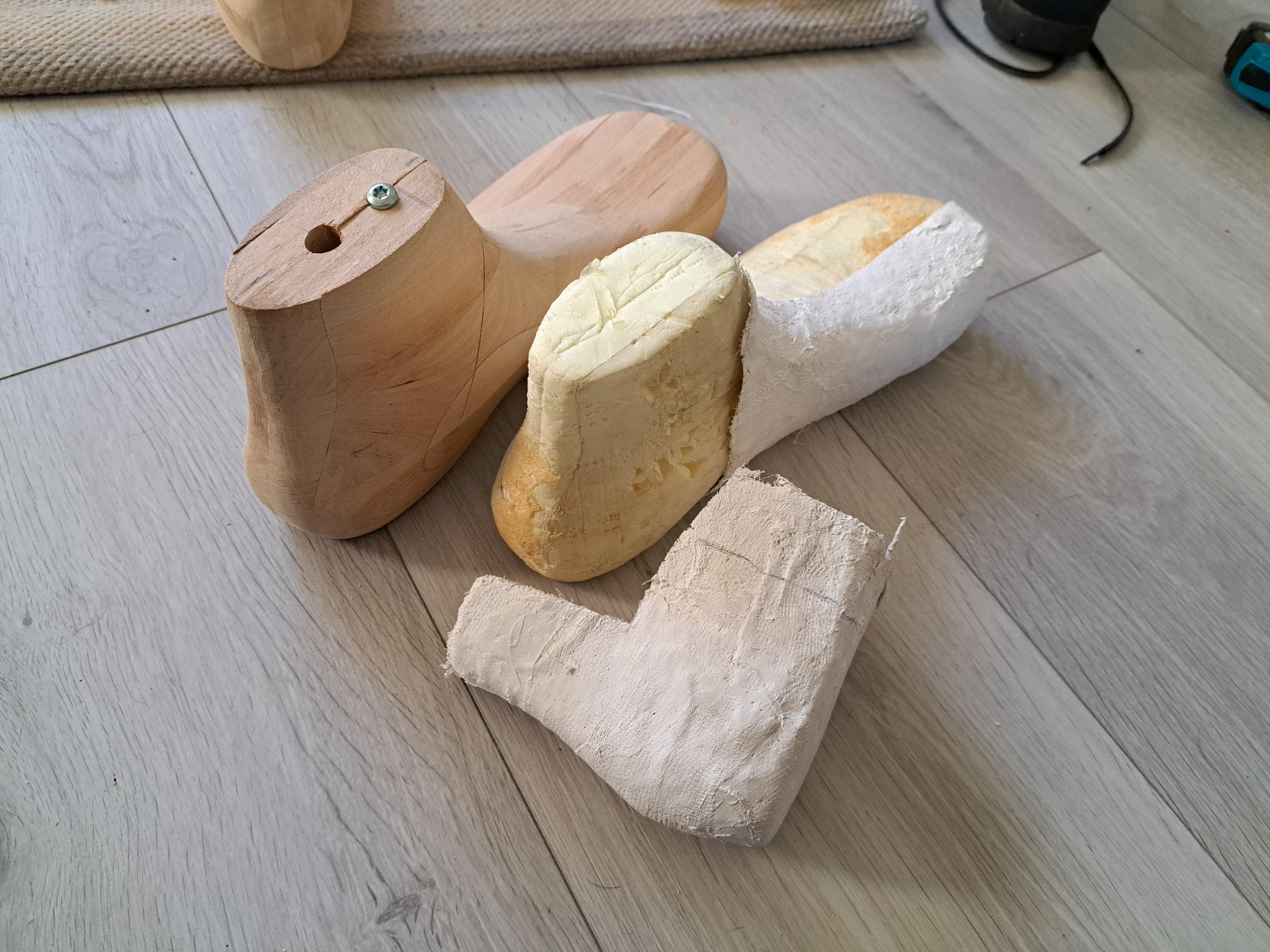

  4. Here are the foam model and plaster casts. I was thinking is there reason for making sides more flat because of heel area. How you can fit leather tight on heel.
  5. Well I first made the last model from polyfoam and covered it with plaster cast. Then I was able to test how it fits to my foot. I made tens of measurements before making model. I felt the model was good and I started doing the wooden last based on this foam last. But know I have made this last sides based on my foot measurements. Like there is bones that needs that extra thickess on sides. But all the lasts I have seen, are more slim and dont have this kind of shape like I do now. I was thinking that there might be a reason why sides need to be different from actual foot measurement.

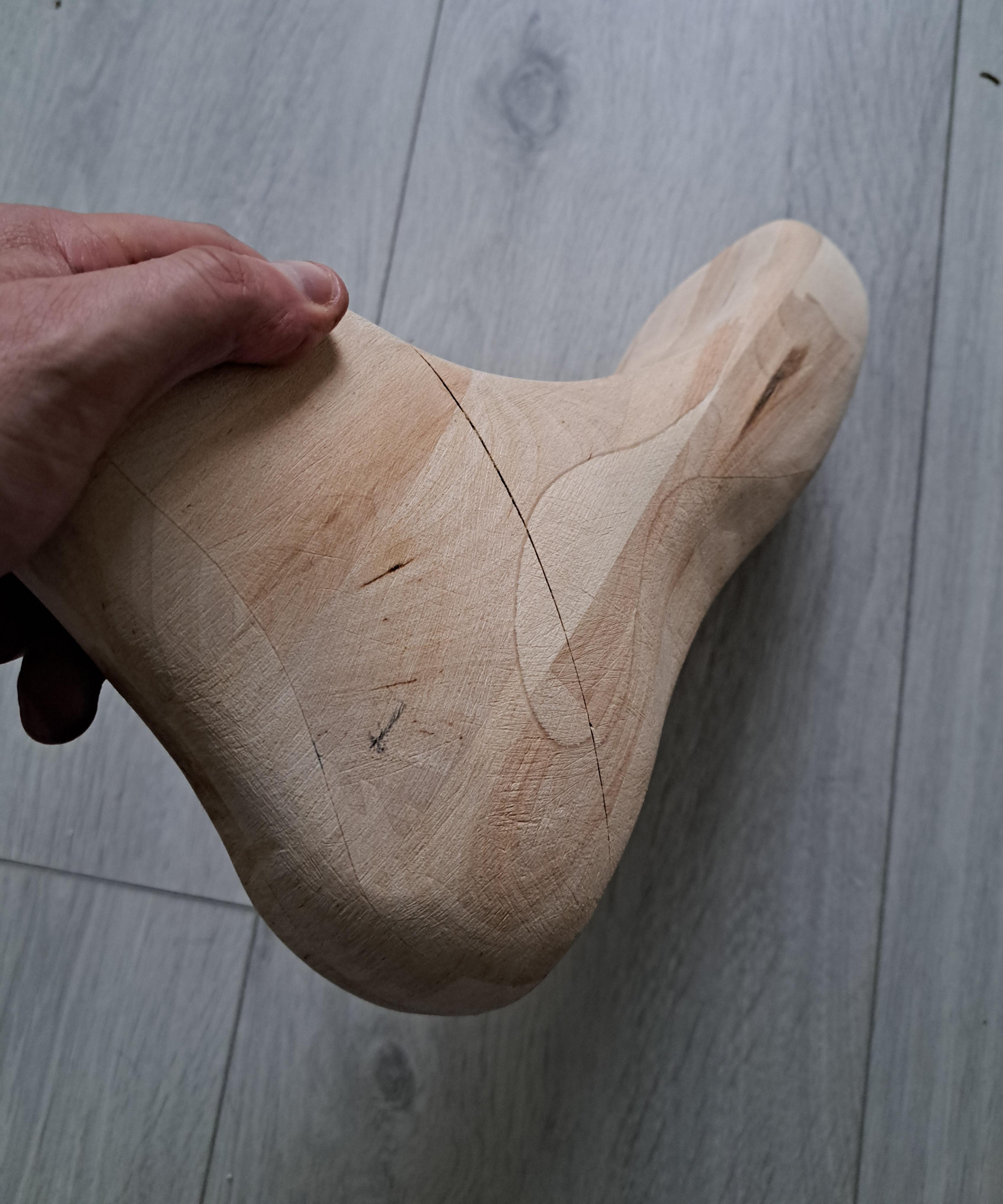

  6. I am working last for working boots and thinking is the last correctly shaped. The sides of the last is more like convex-form (does not thin-out so), when commercial lasts and other I have seen are more thin and not having this much material on the side. Should I remove wood from sides? See the image with green line what I was thinking of.
