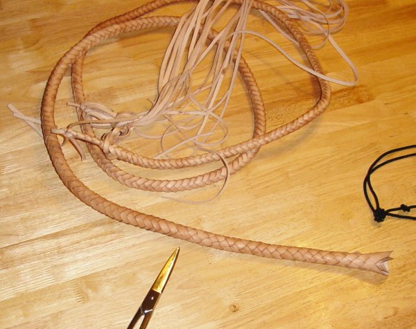

I plaited a twisted-leather core in 4 strands, and then did an 8-plait over that. In the 8-plait I did the "handle" area in 1-over-1-under for a bit, then switched to 2-over-2-under for the rest of the length. I noticed that there are two strands (opposite each other and in the same direction) at the transition that are 3-over. I re-did this bit a few times but could not get rid of the 3-over strands. Is there a way to do a perfect transition from 1-over-1-under to 2-over-2-under or not? (the scissors are pointed to one of the 3-over strands) ....Also I was wondering, does the plaiting soap (Ivory and lard) need to be kept refrigerated or not? ~

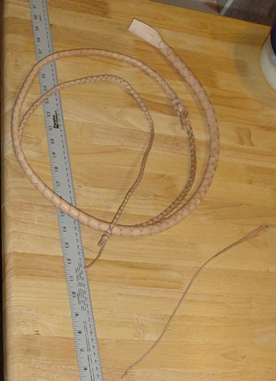

The first time I tried to cut out the plaiting I made a layout/mental error and only cut it half as wide as needed, and only 3/4 as long as I had planned. So I threw that piece aside for the moment and tried again, and managed to do it the second attempt fairly accurately. After I plaited it around the shot core, the end result was pretty thick. .....And heavy. It will work for the dog use I mentioned, but isn't real lively, and wouldn't crack at all. It's only got the 4-plait, and I won't bother adding any more. Just for fun I decided to braid up the first attempt at cutting plaits, to see if I could make a smaller whip out of that. I left it without any core, and with a fall and cracker added it wouldn't crack at all. ,,,,, Then I got the bright idea of tying the little 3.5-foot whip onto the end of the heavy 4-foot whip. The first thing I noticed is that one eight-foot-whip is way more fun than two four-foot whips. :D The "stacked" whip will sometimes crack quite well, when it is lined up just right. The carry-through action is lousy because of the uneven transition from one whip to the other, but I expected that. Also I notice that it eats falls. I was using the same 2-3 oz. leather for the falls that I used for the braiding, and was ejecting crackers sometimes every 2nd or 3rd crack. I can see I'm gonna have to go to the leather store and get something thicker. For crackers I bought some mason's twine (white nylon/polyester/polypropylene), some Power Pro braided fishing line, and some cotton twine. I got the braided fishing line because I was aware of how strong it was for other uses. The 10-lb I got is rather fine, but doubled-over about ten times it does okay. Except for how it's colored.... And now I also see why some whips have crackers that are bright red. I had the fishing-line cracker on and was outside, and the fall end broke off (again) and the dark green cracker took off and landed..... in the green grass. And is still laying out there somewhere on the lawn, several hours later. The hardware store sells hot-pink mason's twine, and I think I may switch to using that. Also I am working on a longer, twisted leather-core snakewhip now, 12-ft or so thong. 8-plait over 4 is what I am thinking of at the moment. ~

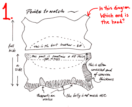

A couple other questions have come up. Question #1: In the Ron Edwards book, he shows a diagram of a cowhide side with various areas marked off as to their suitability for plaiting. He does not explain which end is the head end. I would guess, pointing towards the right side? Question #2: I bought a 2-3oz (about 2mm thick) side of natural color cowhide, and it has a very obvious (and considerably large) "neck" area on one end. What is the leather in the neck area good for? I do not recall either of the two books I have mentioning it. I cut a small piece out of one of the "armpits" of the side to make something, and could feel how much more stretchy it was compared to the main areas of the leather. I pulled around a bit on the neck leather, and it does not seem overly stretchy toward the center area. Aside from any scars and tick marks, is the central leather from the neck good enough for plaiting or not?... -fini-
