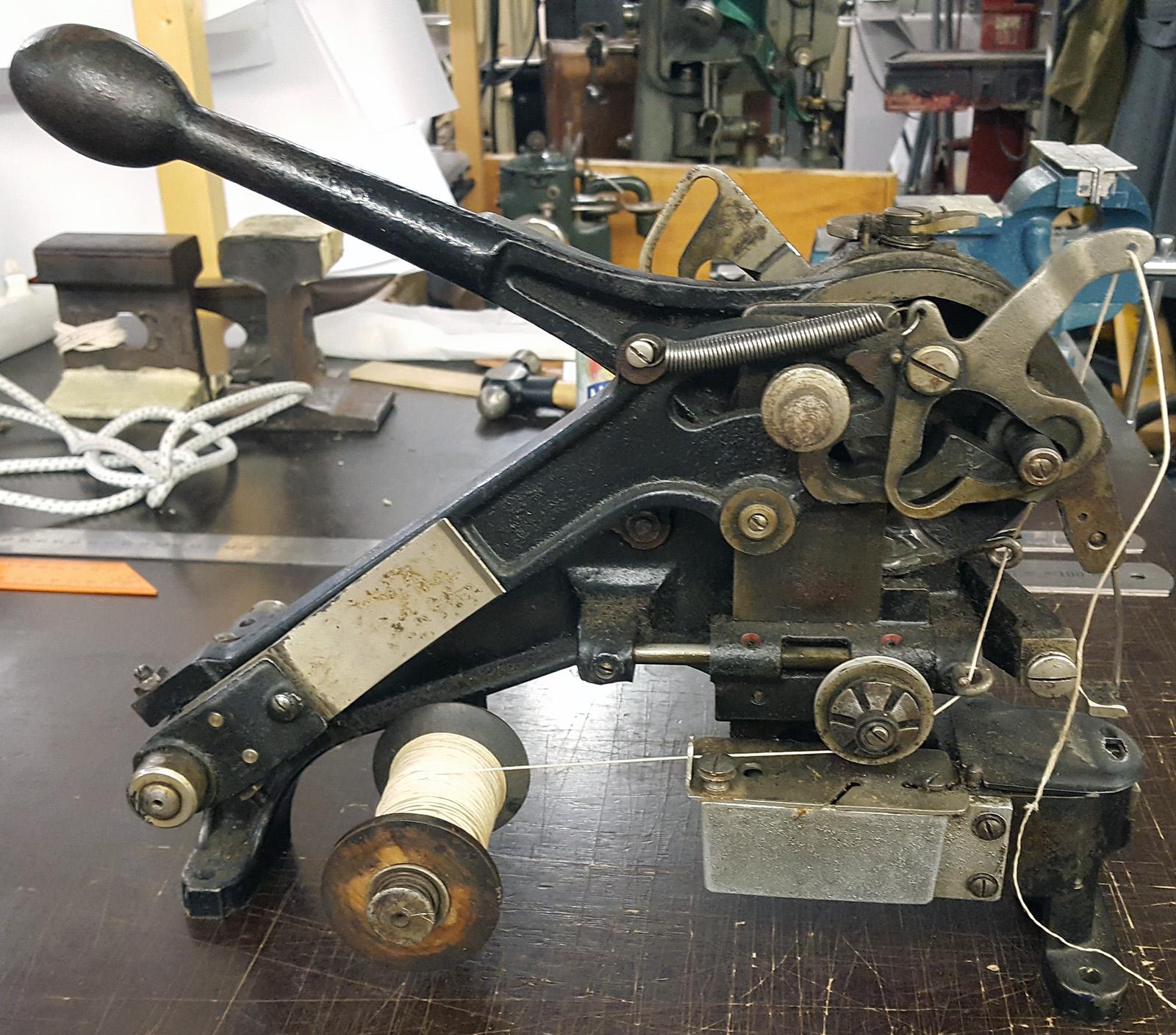

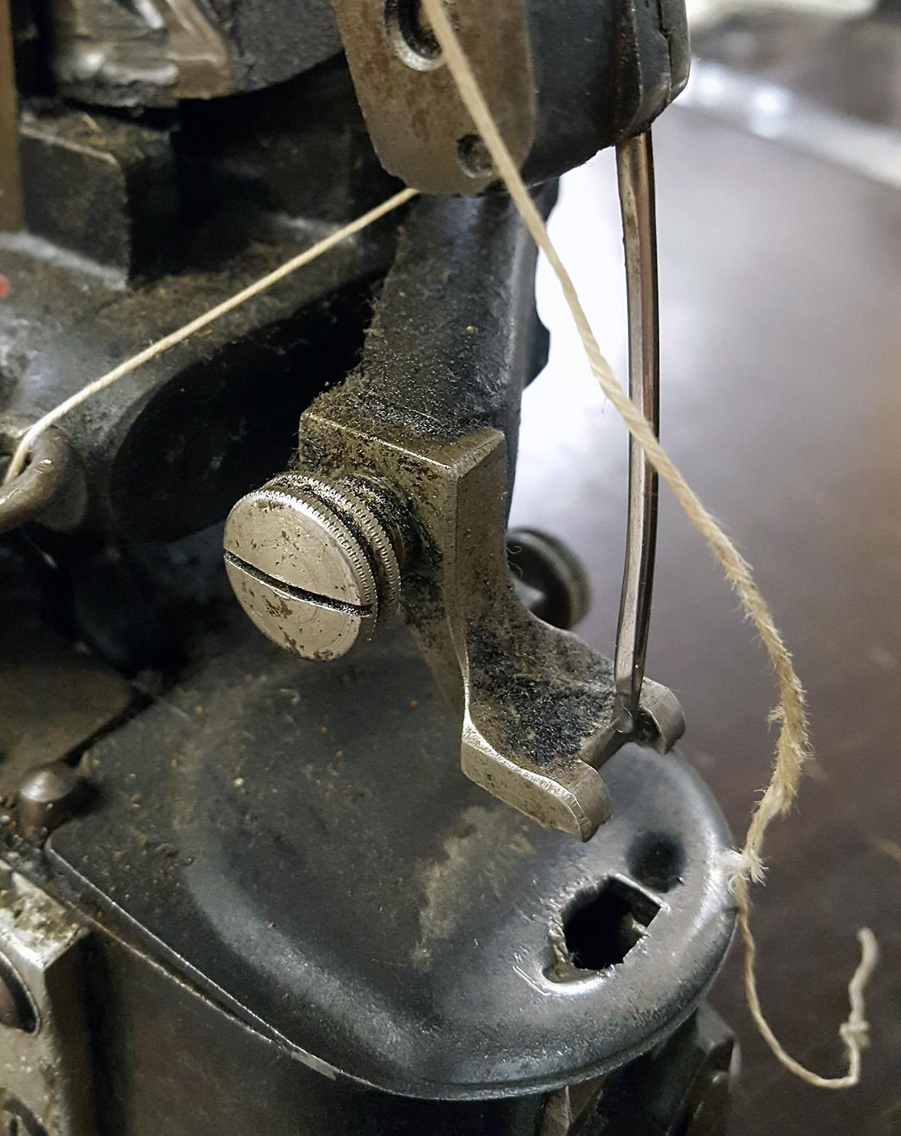

Thank you. I'm fairly sure it's for a heater then. -
I am doing some heavy maintenance on this Pedersen 309 outsole stitcher I got for cheap. What are these wires going into the bobbin case? Are they for some kind of heater for the bobbin thread wax, or am I way off? Thank you for your assistance.
