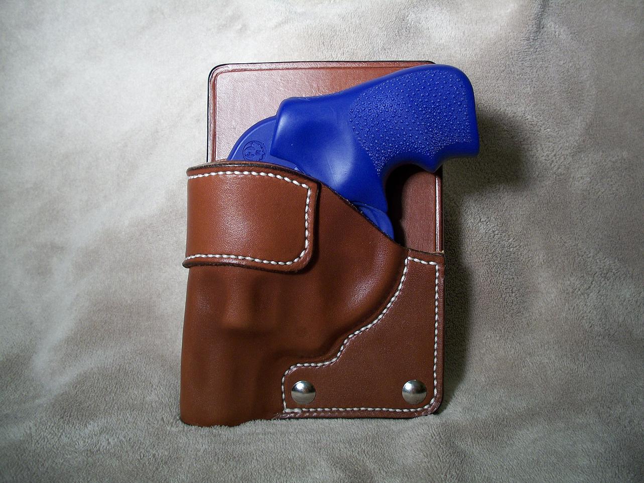

  4. The Chicago screws are holding the actual holster to the print panel. I couldn't really think of any other way to do it with this particular model of gun. To me the LCR seems kind of bulky to carry in a pocket. It fits fine in cargo pants (which the customer wears) but I definately wouldn't recommend it for any type of jeans.
  5. This is my 2nd holster and 1st pocket holster. It's for a Ruger LCR .38 special. Not a big fan of pocket holsters myself but it's what the customer wanted. Honest critiques greatly appreciated. P.S. - Sorry for the poor photography.
