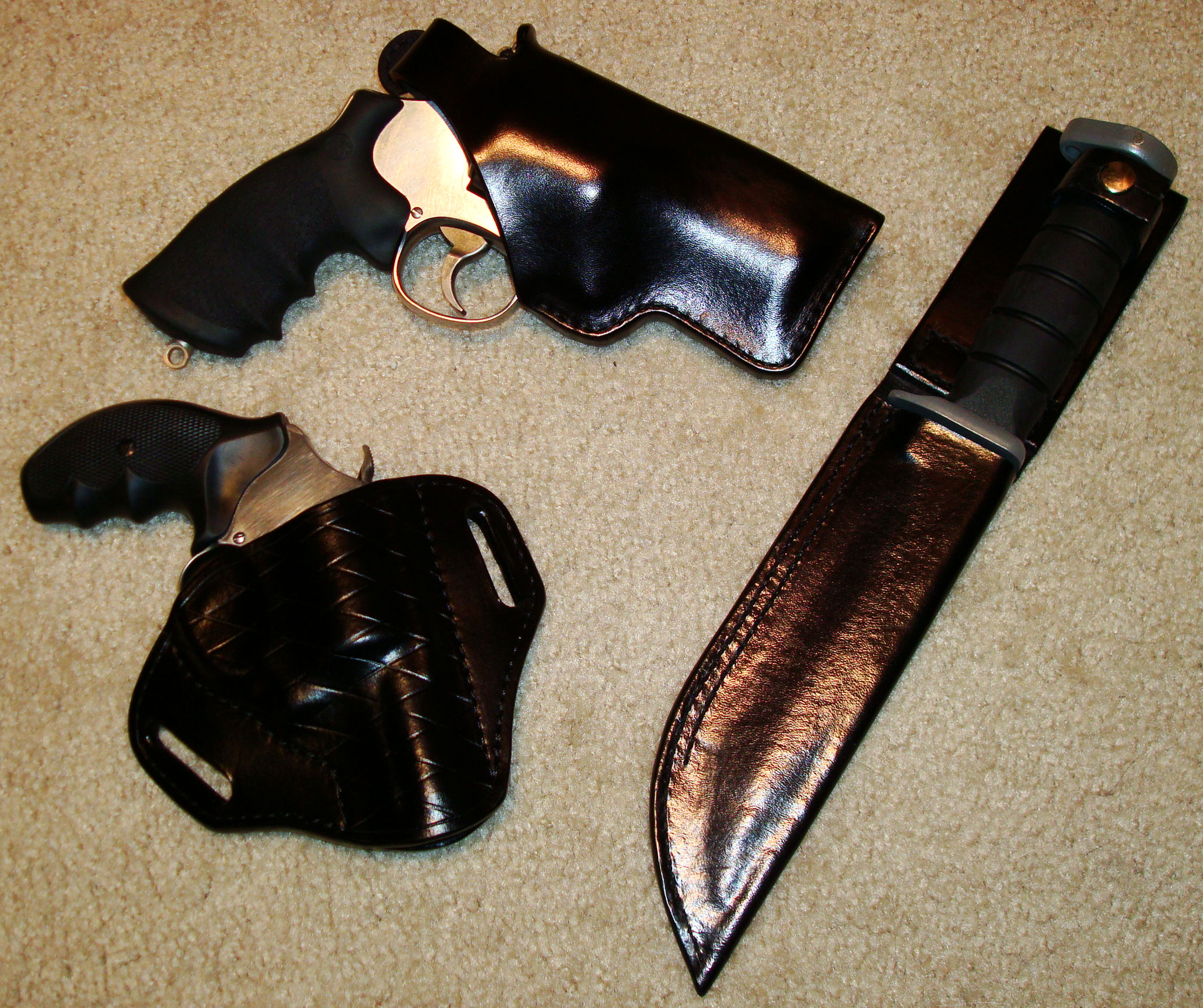

  1. Well, here are the projects thus far... First was the KaBar sheath, then the J-frame pancake holster, then the .44 mag field holster. Still learning a lot, but I'm loving it. I'm currently working on a 1911 belt-slide design. I'll post pics when it's done. Thanks everyone, for all the help!
